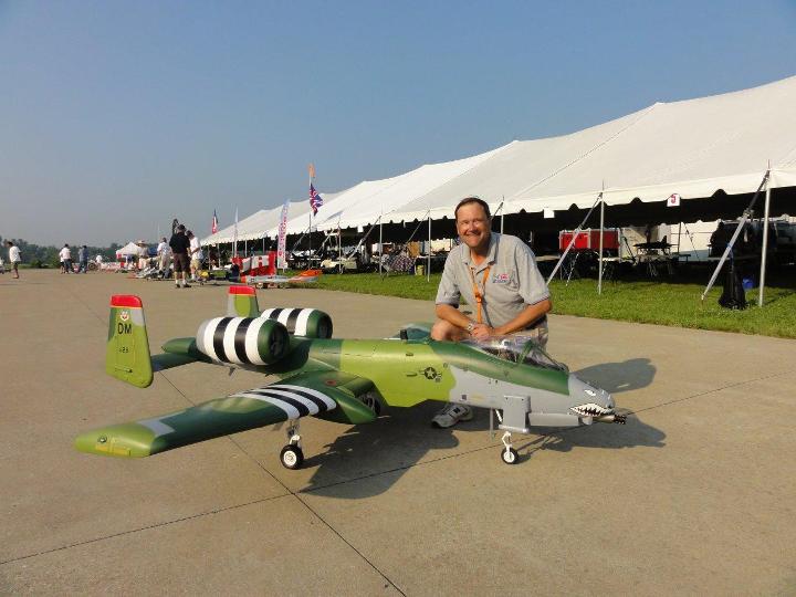

Thanks for the detailed explanation; now you know why I use and recommend your products to my jet friends. I will just request the Expander that I had originally ordered. They give me peace of mind even in my A-10 Warthog.

Glad I could be of help. A-10 looks very nice. Thanks for the picture.
