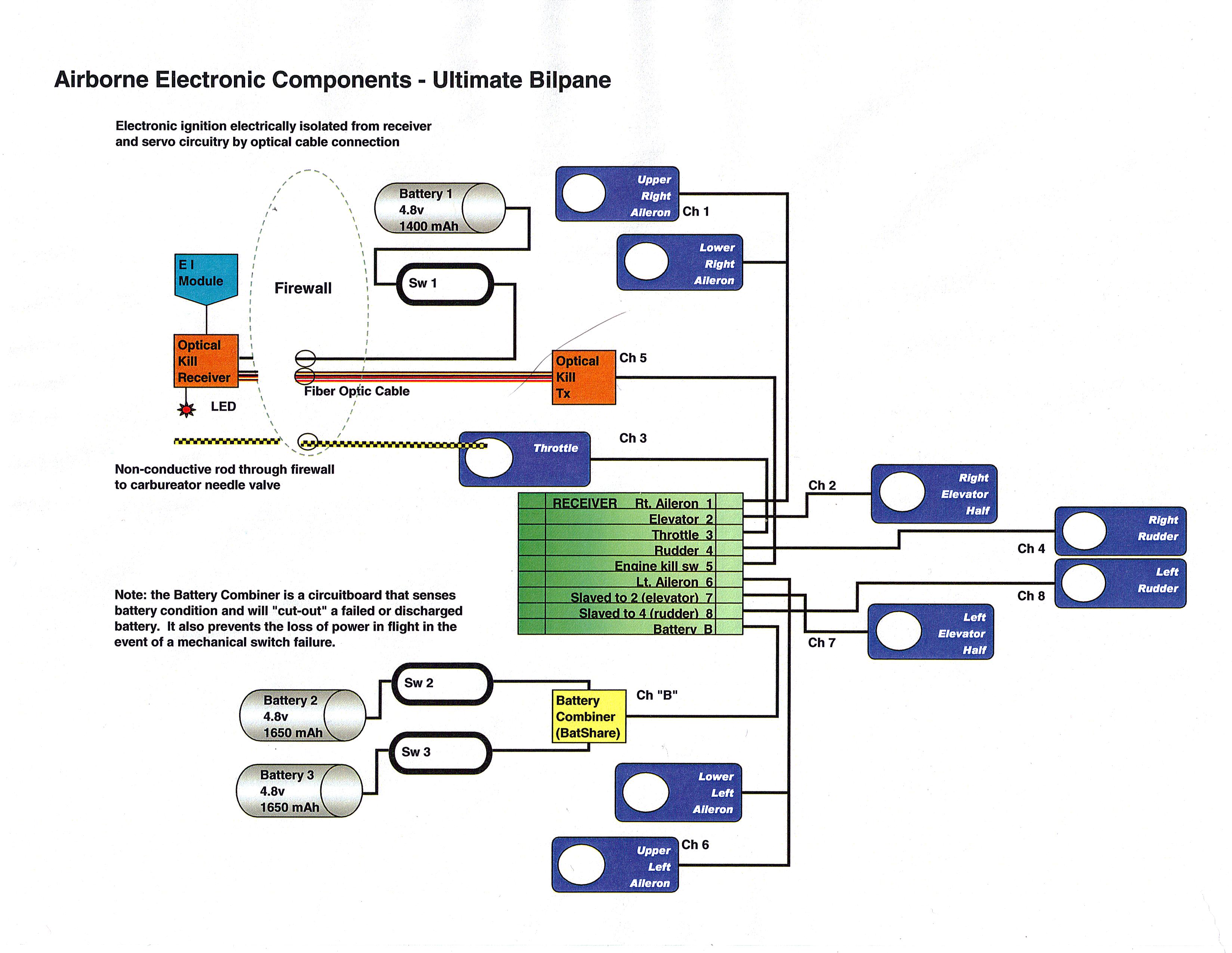

I really need a wiring diagram of the Smart Fly Opti Kill cutoff single receiver
separate battery for ignition. Using the Sport Plus Expander.

I haven't used an expander, but your OptiKill will just be on an open switched channel. I use the same switch to kill the throttle on my glow and simple gas models.
