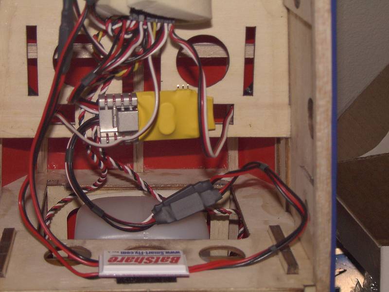

So I got my new goods today and I have a question about mounting them in my airplane. I don't like the idea of small electronics flopping around while I'm doing manuvers so I would like to use some velcro to mount them to formers etc. Is this ok or do I need to use something like double sided foam tape?
Also, if I use a voltmeter with a simulated load of 250mA, is this enough to set the regulator?

Hi Ben,
You can use velcro. This is how most people mount these.
250mA will wok fine to se the regulator.
Let me know if you have any other questions.

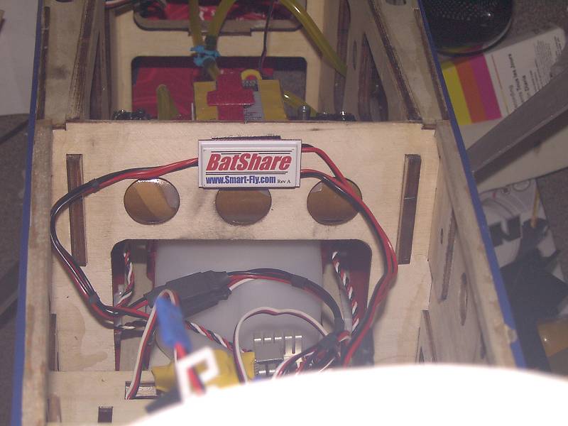

Well, I got everything mounted tonight. It's not like there is much to do there and then I set my regulator to about 5.5 volts. That was a good place to me and plus I checked my previous model regulator and they were at about 5.5 V loaded. Now I'm definently putting a power expander from Smart Fly in my Dalton Extra 260 when I get it over some Emcotec system.

Hi Ben,
Looks nice. Let me know if you have any other questions. Thanks for the endorsement.
