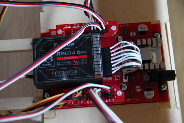

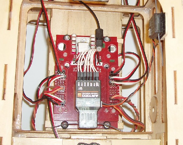

ORIGINAL: johnnyzhao
Hi Robert
Can you give me some pictures and features for the new PowerSystem Sport Plus?
And also the price please.
Hi,
Here are a couple pictures. The name on the unit is wrong, it took a while to decide on one. The units are eight channel units, have two servo outputs per channel. They support two batteries in with protection from shorts and dead cells. The inputs are standard R/C connectors. The regulator is fixed at 6 volts and is rated at 5 amps continuous power with 10 amp peaks. The Ignition Cutoff is built in and you select your cutoff channel with a jumper from the channel (off the PowerSystem or straight from the receiver) to the Ignition Cutoff control input. The PowerSystem Sport Plus will be $199.95. There will also be a PowerExpander Sport Plus for NiCd/NiMH, no regulator, out in July. Price is not set on that yet.
