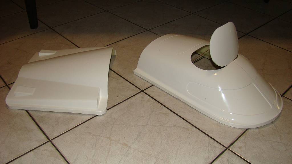

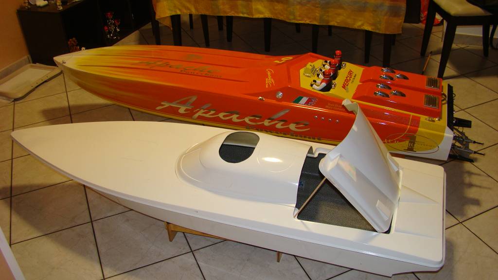

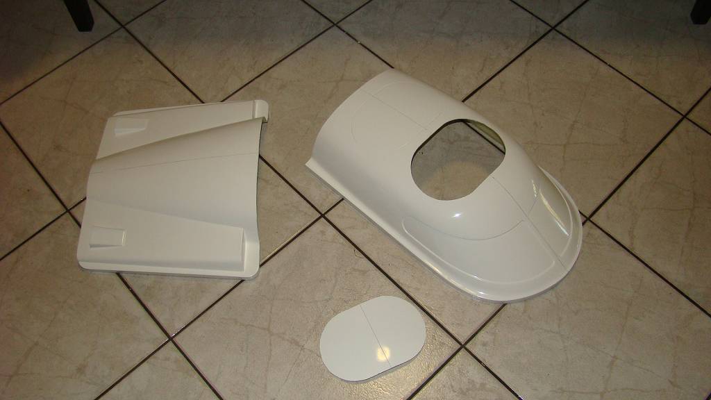

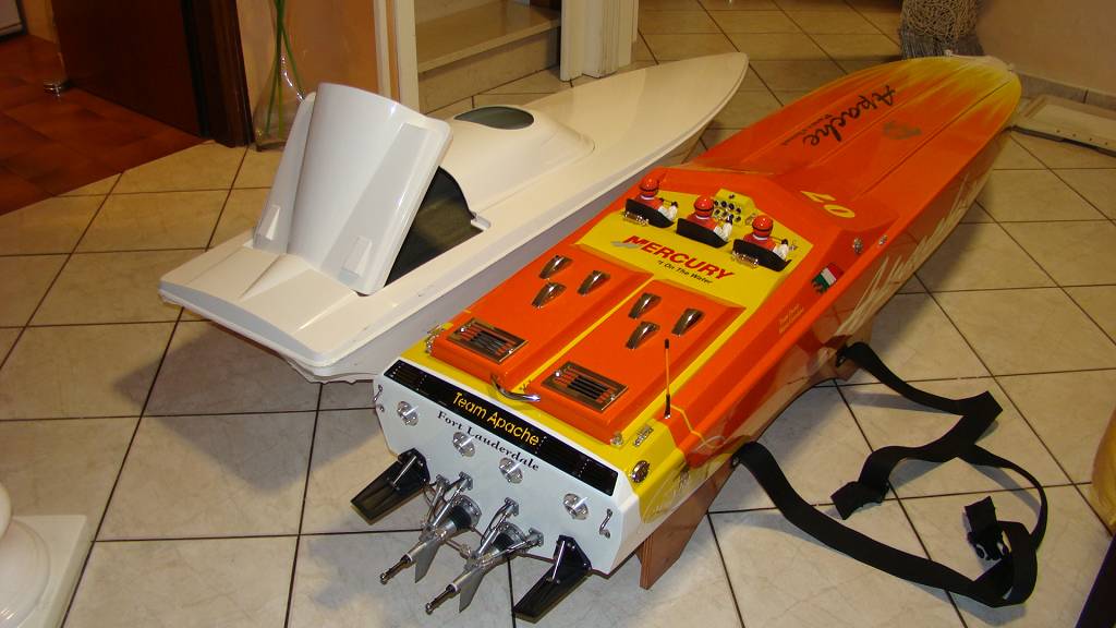

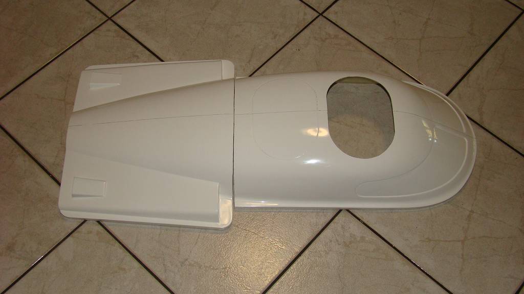

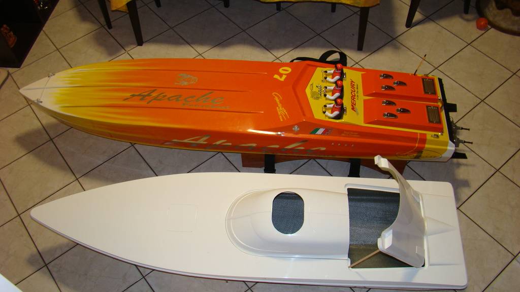

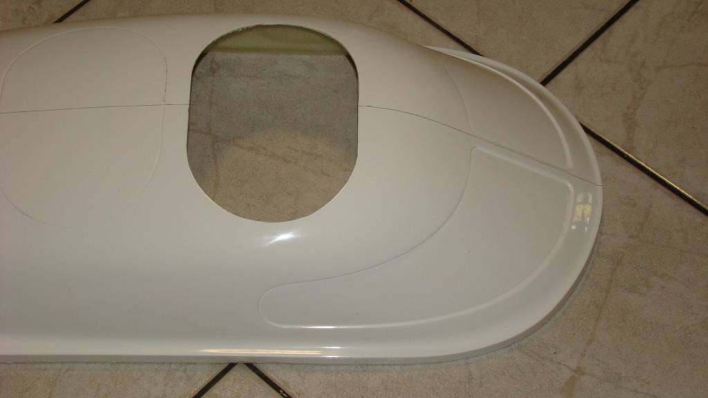

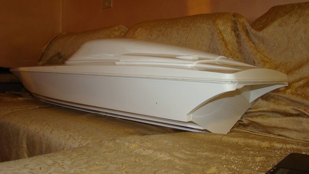

Hello guys, i finally decided and took this hull that is <span class="hps">a long time</span> <span class="hps">that</span> <span class="hps">I wanted. Mart, from waveriders models, told me some time ago <span class="hps">why</span> <span class="hps">not</span> <span class="hps">try</span> <span class="hps">an</span> <span class="hps">electric</span><span>? So i'm thinking to do it, i know that this is a very big boat but <span class="hps">someone</span> <span class="hps">has already done it (video) so why not try myself. I had seen some motors arround, but <span class="hps alt-edited">my main target is the running time, here in italy i was advised to use brushed motors <span class="hps">to have greater running times, becouse <span class="hps">brushless</span> <span class="hps">have</span> <span class="hps">more</span> <span class="hps">power consumption, what do you think? <span class="hps">What kind of</span> <span class="hps">setup</span> <span class="hps">do you think</span> <span class="hps">is better for this boat? Consider that i will mount z-drives on it.
Here are some pics. Thanks

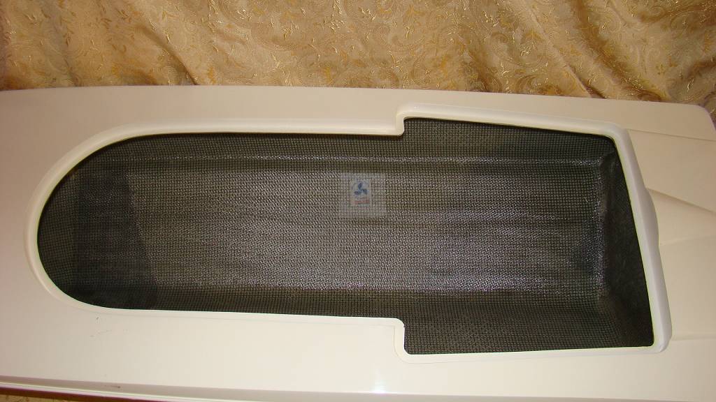

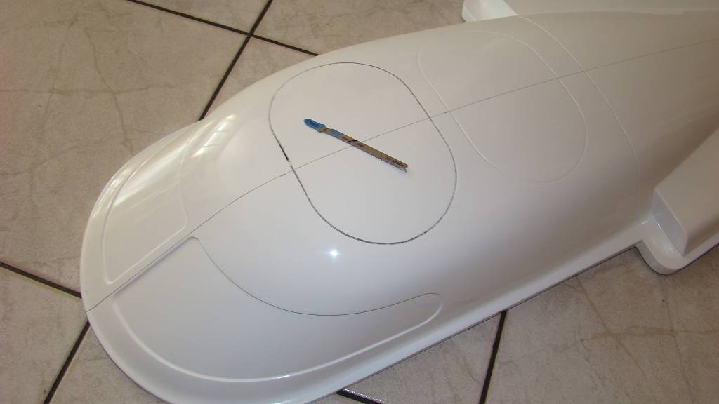

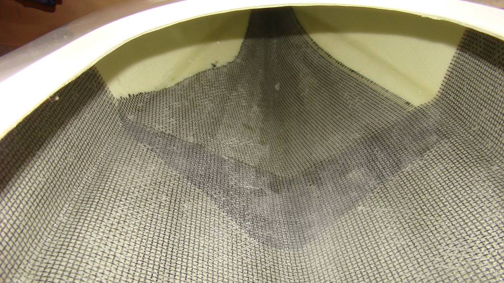

<span class="hps"><span class="hps">I started to</span> <span class="hps">do some work</span> </span><span class="hps">in</span> <span class="hps">the hatch, here are some pics.</span>
One thing you need to remember with Electric is you need to be able to seal that hatch so its completeley water tight.I think Brushless and lipos is def the way to go,5692 motors might work,voltage is upto you, personally im going with twin 5694 1000 kv motors in my 58 Apache on 6 s moving upto 8s later problem with going upto 10 s is you then need to spend big $ on hv escs.If you choose hig voltage then go with lower kv and larger props.Thats a massive boat youve chosen to go electric on though.

Thanks Mart, yes, you're right, as i said in another forum, the inside will be completely isolated with a plexiglas mod.

This is a very large Fountain replica. A twin setup is the best choice with 10S for each combo esc/motor.. A 600kV motor should be great.
