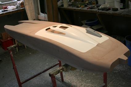

The plans are for a 34" hull if memory serves,you can either take the files to a printers or print seperate sheets and tape together which is tricky but doable.Ill post a pic of a 70" hull someones made from these plans its awesome.
Mart

Mart, Do you know how this boat, made from the plans, performs?
Old 01-31-2013 | 06:16 AM
martno1fan's Avatar
Joined: Jan 2005
Posts: 11,390
From: blackpool, UNITED KINGDOM
Default RE: Cat Hull Plans
ORIGINAL: Ratliff
NO idea but see no reason why it wouldnt perform well.
