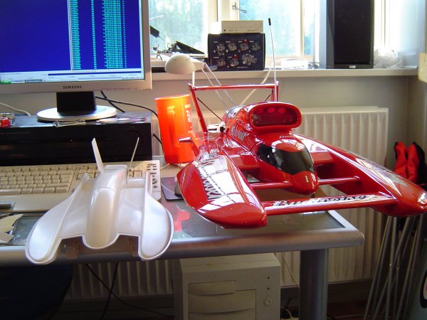

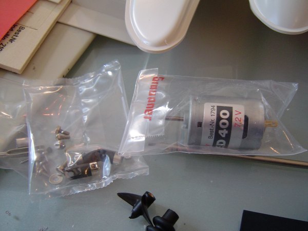

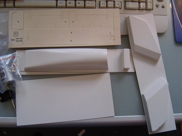

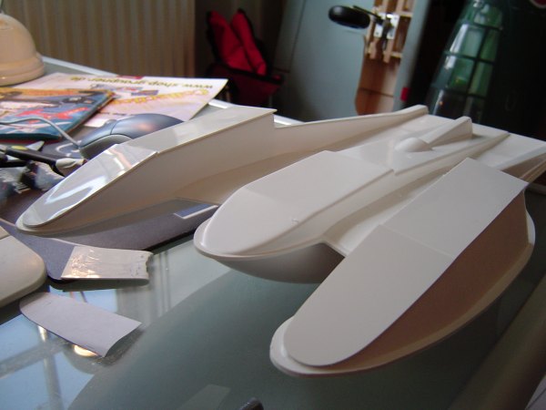

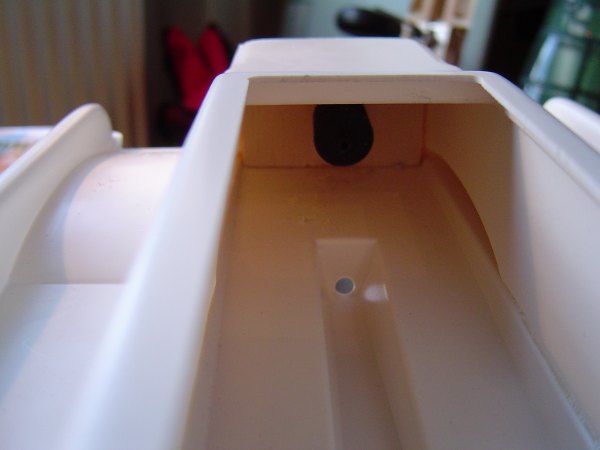

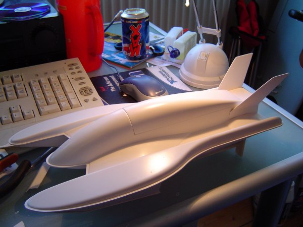

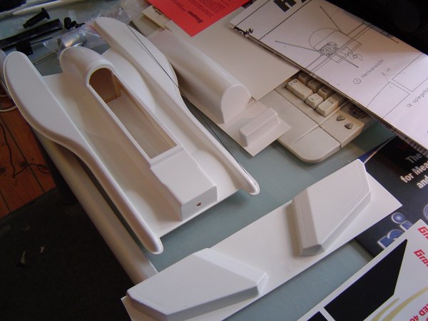

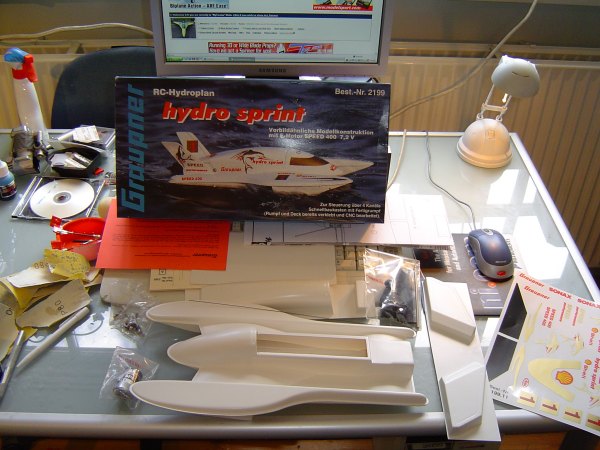

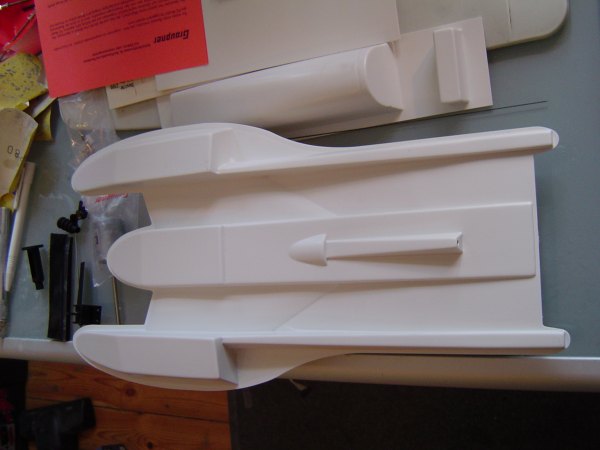

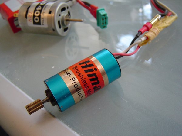

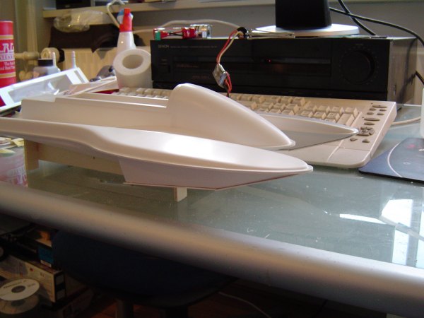

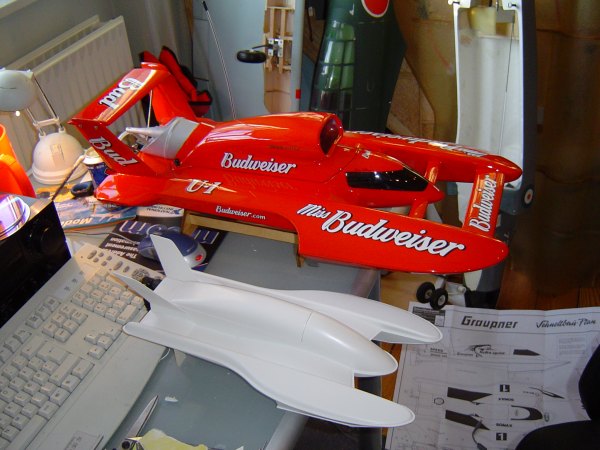

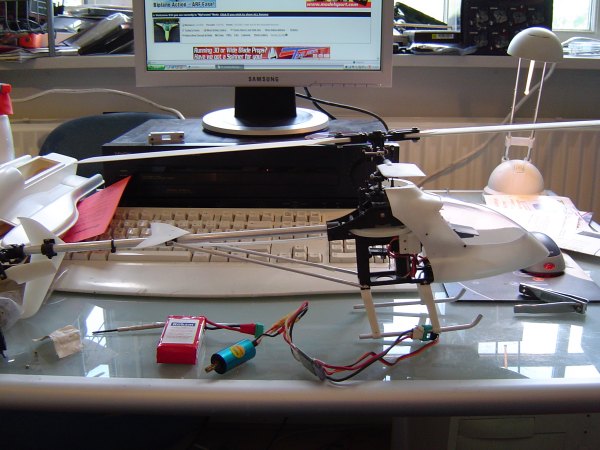

Just bought a Hydro Sprint to play with
Stock motor is a speed 400 7,2V , but I want to try my Himax 2025-3200 brushless.
I have no ideait it will run right with this motor.....but its worth trying
Here are some pictures of the kit.

Old 07-22-2005 | 09:43 AM
SJN
Posts: 6,326
Received 7 Likes on 7 Posts
From: Copenhagen, DENMARK
Default RE: Graupner Hydro Sprint

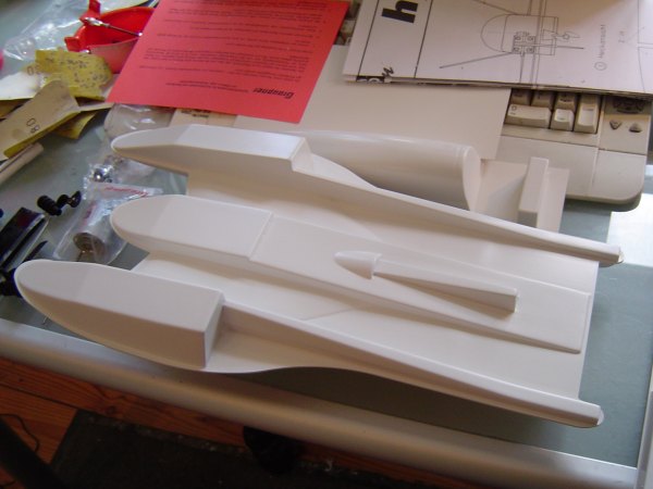

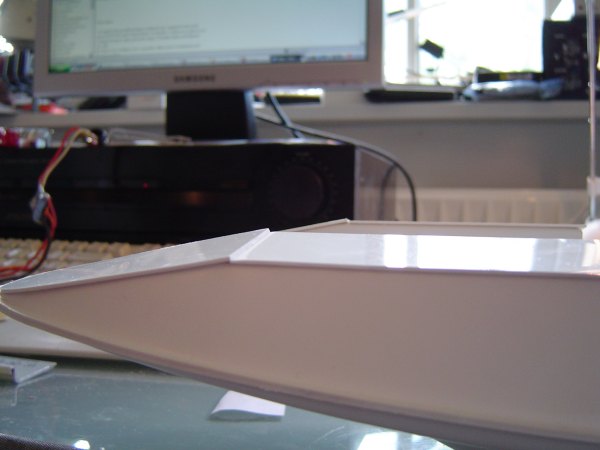

Old 07-22-2005 | 11:52 AM
SJN
Posts: 6,326

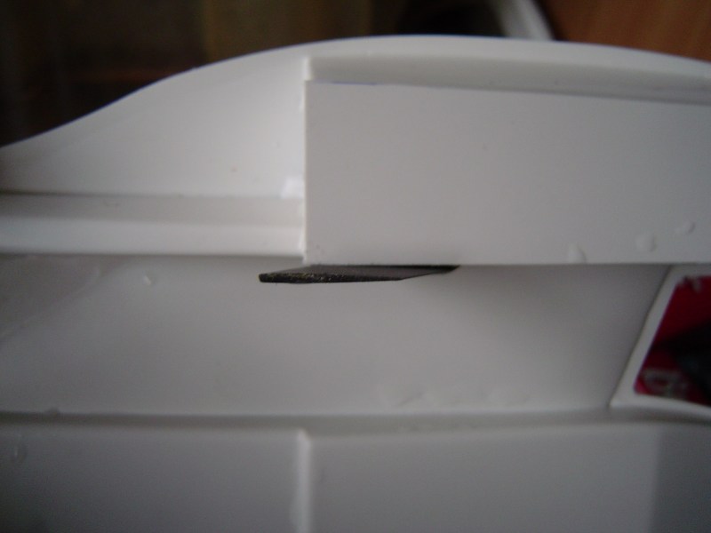

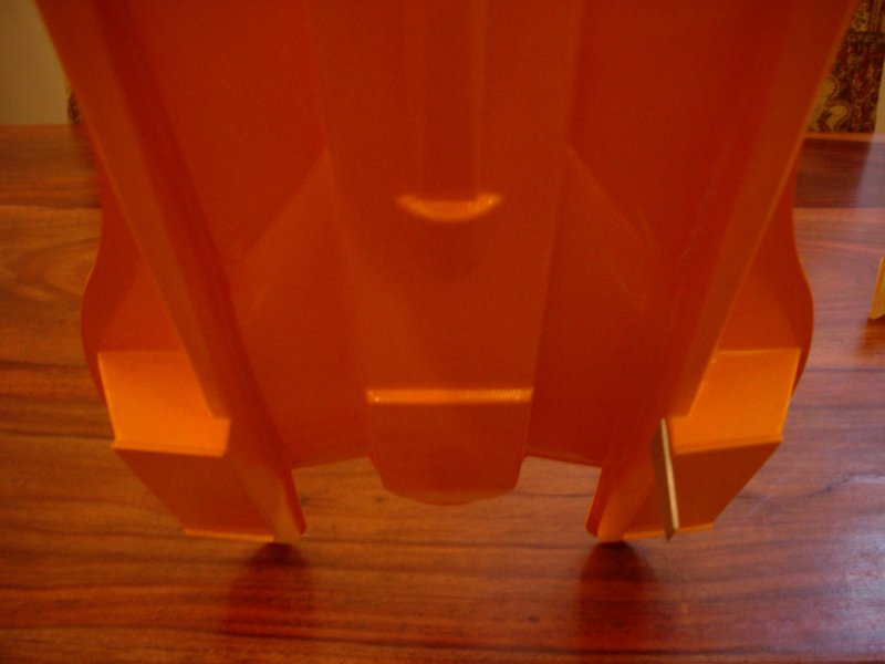

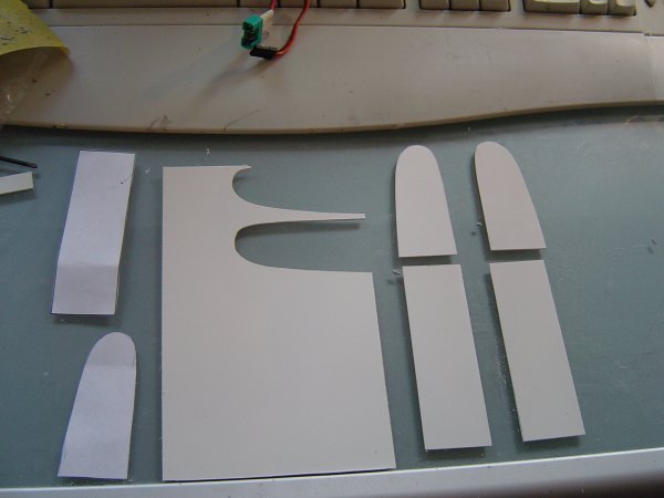

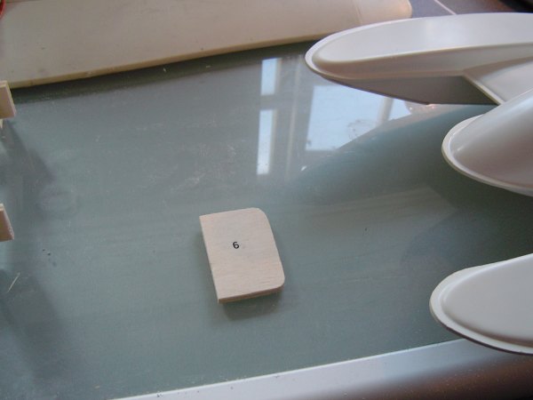

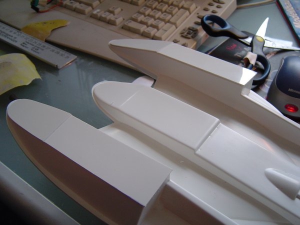

Making the "steps".

Old 07-22-2005 | 12:05 PM
Gaijin's Avatar
Joined: Jul 2005
Posts: 83
From: Portsmouth, UNITED KINGDOM

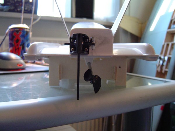

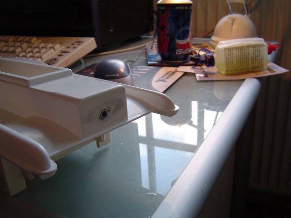

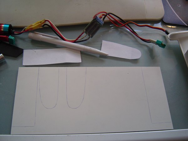

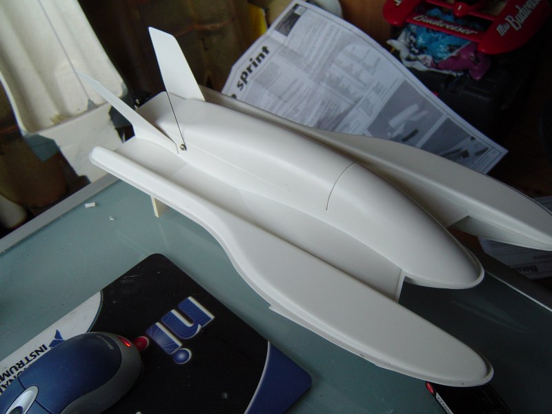

Hey SJN,
As you know I have a sprint and a brushless setup just like that, I toy'd with fitting the brushless in mine but after testing it with a 400 6v I decided against it, here are my reasons:

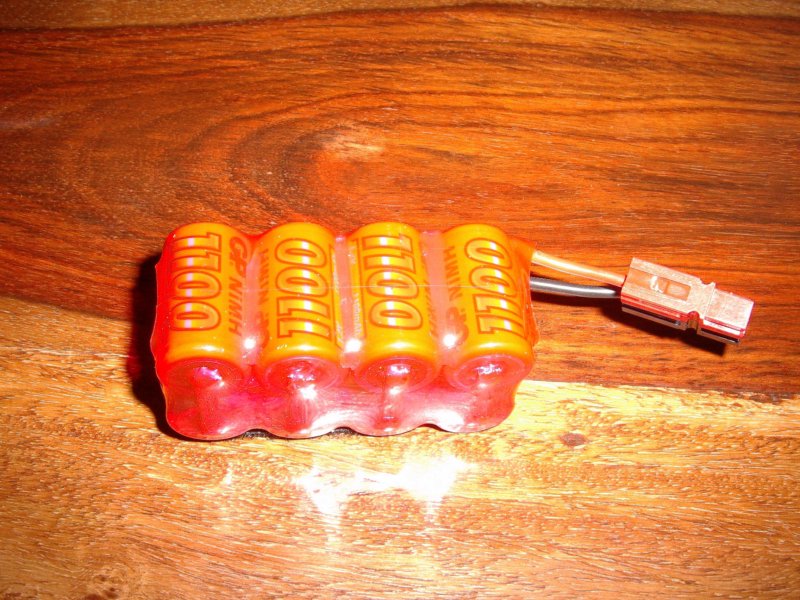

1) The brushless ESC is about 2/3rds of the size of the motor and it was going to be a squeeze to fit it and still be able to remove/replace the battery pack
2) The brushless gets hot and as I'd already fitted a switch in the rear I had nowhere to fit a cooling inlet.
3) the motor mount is ideal for a 400, but is only fixed on the shaft with cyano, it's already twisted free once with just the power of the 400, If you fit the brushless it'll need reinforcing or it'll tear the driveline apart.
4) It was already crazy fast and as the hull barely touches the water I feared it would be damn near undrivable with all that power, which is why it's going in my Gecko instead
However I'd love to see one in action, keep me posted
Couple of tip's I picked up building mine, keep the sponson edge's and ride point's square, it doesn't mention it in the instructions but it really reduces friction.
Uncase the receiver if possible it already takes up a lot of valuable space, make an aluminium turn fin the plasticard one has too much flex
Enjoy, I love these things, micros are the future!

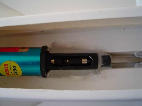

Old 07-22-2005 | 12:44 PM
SJN
Posts: 6,326

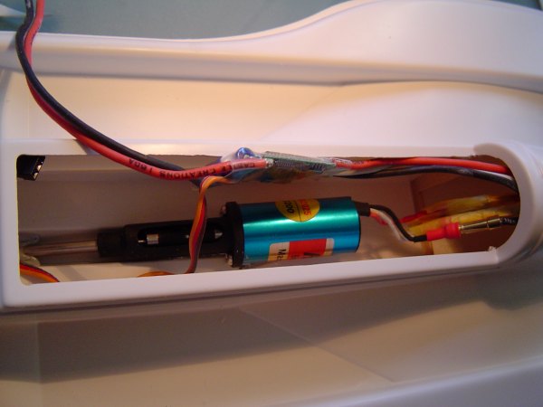

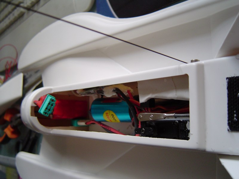

hehe, thanks for the tip.
Ill secure the motor better.
Im "gluing" mine into the hull with some Rubber RTV, so I can caut it out easier later if needed.

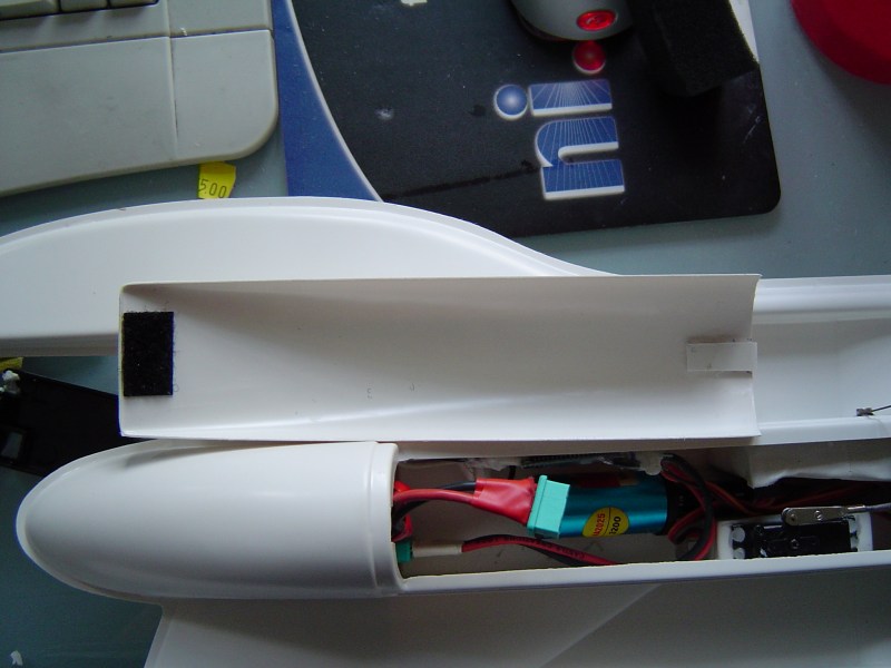

Old 07-22-2005 | 12:50 PM
SJN
Posts: 6,326
Just gave the black coupler some more........this should hold it down.

Old 07-22-2005 | 01:07 PM
Gaijin's Avatar
Joined: Jul 2005
Posts: 83
That looks pretty good should brace it well against torque.
Keep up the good work...

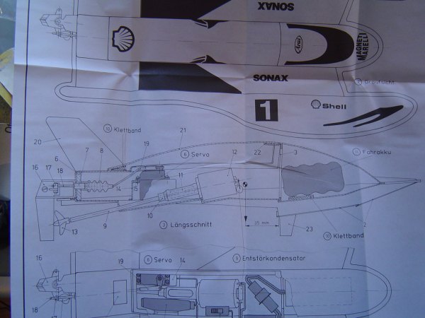

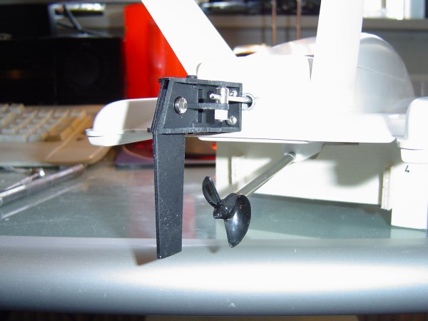

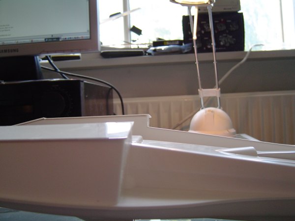

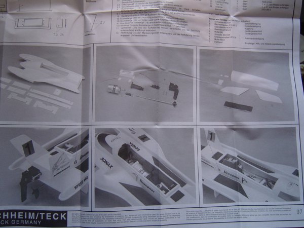

Prop depth looks quite deep......but it is exactly in accordence with the 1:1 drawing.

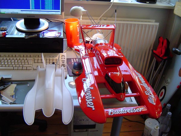

The prop looks ideal to me, don't forget that it carries quite a lot of weight relative to it's size (not so much in your case, be careful that it's not too light!) so it'll sit very low in the water at rest and needs a deep prop to bring the rear up.
A top tip I got from somewhere else is to go straight for full throttle at startup, if you try to idle the cell pack weight will literally dive the nose below water (believe me I've done it), ease back on the throttle in the turn or it'll spin out.
By the way, love the miss Bud, something of a work of art those proboat hulls...

Yea, the Bud looks fantastic.

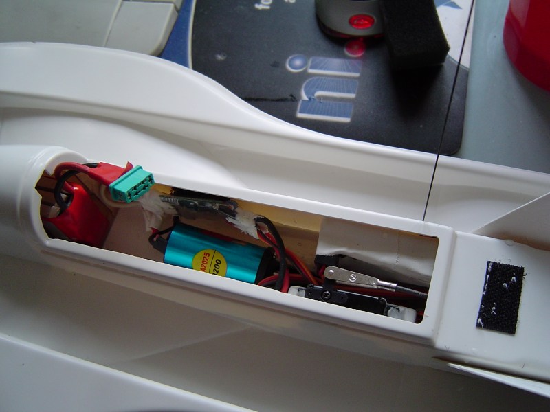

Had some time to finish her up, and went down to the lake to give it a sprint
Well, Im pleased, and a little disapointed at the same time. This motor is very powerfull......maybe too powerfull
It scoots along nicely at around 1/3 throttle, but if I go to 1/2 throttle, the nose lifts quite alot off the water, and only the front turn fin is in the water. As the fin is on the right side, the boat veers to the right all the time. If you correct slightly with some left rudder, the left pontoon contacts the water, and it turns violantly to the left......it keeps zig zaging like that. []
I might try to remove the tunfin, or add another on the opposit side....... and se what happenes, and try to move the CG a little forward.

Nice job, you should be pleased!
I think you might be right, it's a combination of a lot of power and not enough nose weight, even with a 400 mine is pretty skittish and takes a lot of corrections to keep on the straight and narrow, I don't know about the extra turn fin as this will increase drag and you might find it wont turn in either direction well as it is supposed to pivot around it.
I'm curious, what's the all up weight, if you are well short of the recommended 550g, I don't see why you can't ballast it up a little in the nose or even up to say 600g all over to calm it down a little, it's not as if you lack power to move the mass!!!
If it's any help my 2/3A 9.6v cell pack weighs 175g, I expect your Lipo's are half that AND higher voltage (11.1v right) so more weight can't hurt
How high is the heat from the motor and esc after the run?
Old 07-23-2005 | 12:41 PM
SJN
Posts: 6,326
Hi Gaijin.
Im at work now, so I cant weigh the boat.
The batt 1500 kokam 3s pack weighs 105g, so I can insert plenty of ballast.
The motor was quite warm, but nothing to worry about. The esc and battery was hardly noticable warm.
So it cant be using that many amps. But I did not run the pack down. Only sailed for 4-5 minutes below 1/2 throttle.

445g with the liop batt.
I have removed the turnfin, and see what happenes tomorrow

Hi Sonnich,
Nice work on that little monster!
The propshaft angle is much(!) too steep though.
You'll need a flexshaft or a 1,5mm steel shaft (bendable) and a strut, to make the propshaft angle close to zero, or you'll never be able to run full throttle.
Regards, Jan.

Hi Guys.
I tried it again today without the turnfin, and now it can come up to 1/2 throttle safely. It turns quite bad now at high speed.
But now it has a new problem. The prop is "walking" on the water, making the boat yaw sideways. The faster it goes, the more sideways the bout is....even though its going in a strait line!
Thanks for the tip Jan, I wonder where I can get one....

How's it going Sonnich?
Did you try it with some ballast while you wait for the new propshaft?
I recommend you put the turn fin back by the way...
Many boats suffer the same issue of the back shifting to the right, it's called propwalking, the rotation of the propellor pulls it sideways.
Old 07-26-2005 | 08:25 AM
SJN
Posts: 6,326
Yes, I tried the ballast at the same time I took the fin off.
I think the answer is like Jan said....a flex shaft. At the angle the prop shaft is now, it just making the bout fly out of the water, instead of pushing it forward.
