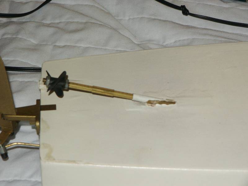

hello i was wondering if anyone has ever built a crcakerbox from the plans on the site microhydros.com
i built one and it turned out relyy good except for one thing thats the drive line i used a stock 540 and i no that is too big but i had it laying around so i thouught wt the heck and well it vibrates to peices i tryed a new coupler and everything i dont want to go with a wire drive do u guys think that i should go with the 480 motor that is supost to be in it ?

Without pics no one can tell you exactly why your driveline is vibrating, but I'm guessing it's because of lack of support. Make sure the stuffing tube is epoxied in good. For the rest of your stuffing tube that in inside your hull, cut a piece of fiberglass cloth and drape it over it, allowing the ends to run accoss the inside of your hull. Then either use a thin layer of epoxy to soak into the cloth, or use thin CA and the cloth will wick it up. What ever one you do, when it dries it will be very stiff and should eliminate the driveshaft vibrations.
It would also be a good idea to do the same with your motor mount.

ok i will try to get some pics and post them for u guys than for the advise i did that i filled the souronding stiffing tubs with gorillia glue and that stuff is strong

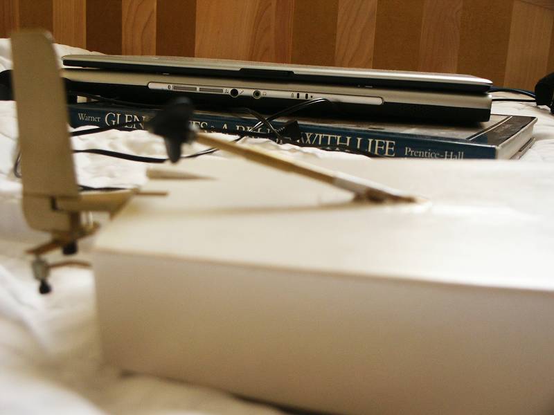

these are the pics if you need more just ask LOL

Part of the problem if not all of it could be from lack of support of your propshaft. If the shaft is even slightly bent, that can throw things off and give you a bunch of vibration.

With the way your hull is cracked around the stuffing tube outside of your hull, I'd say Ron might be on to something.....
