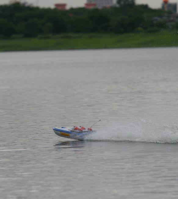

please post your brushless system here , im setting up a 29 inch cat and id like some input as what to put in it for top speed setup im looking to run twin battery packs too

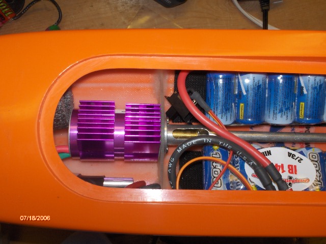

My Gecko is running a 400 Feigao Brushless and 10 Intellect 1400mah batteries and a Hacker 40 ESC. I am still fine tuning it. I haven't had much time lately, still getting settled in since I moved.

I haven't finished testing different props yet, or with the new batteries. My old battery pack has a bad cell, So I will not post this info as it is misleading. I will try to do some testing this weekend and see if I can get someone to run the Vid Cam

Very cool!

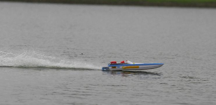

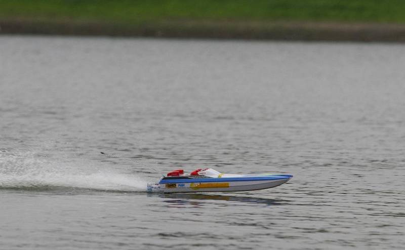

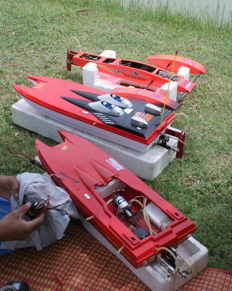

Catamarun
motor : GS B-36-56 2600kv
esc : rooster 70amp
battery : GP4300 12cells
prop : prather S215
