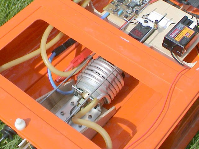

If you can rebuild motorcycle engines, you can easily re-do a CESA. It's just not that hard and there are plenty of people here that will help you at each step. It will take you some time and some money to do but it's a fun process. I know, I've done it twice with these hulls.
Here are some pictures that may inspire you:

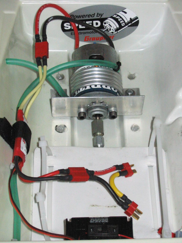

It really depends on what you want out of the boat and how much you are willing to spend. If you want it to be a fairly fast electric then proceed as I described earlier. Also, you may or may not be able to use your Tekin speed controler depending on how it is rated in terms of handling high amp draw... as in 60 amps. If your ESC is rated this high then you could take out the Jeti ESC I show below and reduce the prices by $73.
Here is pricing at offshoreelectrics.com...........(your LHS won't have all this stuff most likely unless they specialize in FE boats)
Without racing hardware (using the stock outdrive) not including battery packs and radio equipment (RX, TX, servo) of course:
ESC - Jeti 600 marine $73
700SC motor - $45
Schottkey diode, set of 3 noise reduction capacitors $1.50
Water cooling set up $12 (700 coil, tubing, etc.)
Motor mount - $0 (you can easily make this from angle aluminum from Home Depot, see pic below of my 800 motor on custom mount) ....................or you could buy one from OE for $6
5mm to 4mm flex connector (motor to drive shaft) $12-$15
45mm CF prop - $7
Trim tabs-turn fin set - $5
12g deans wire and connector pairs x 4, $12
[/b]Total $170[/b]

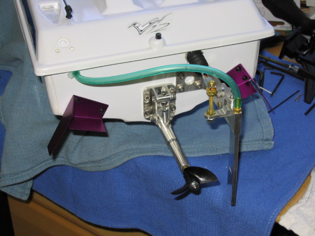

BTW...you will need the $5 trim tabs / turn fins (1.5" long) because when this boat goes fast it does not turn well without them.
