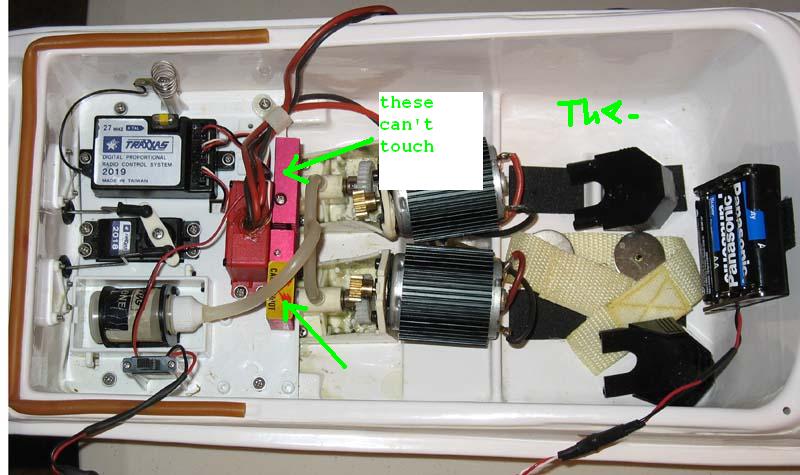

here's what it says on the novak site.
ALWAYS USE ESC HEAT SINKS
Heat sinks are factory-installed on your HV-Maxx ESC and MUST be
used for maximum cooling and performance––Never allow separate
heat sinks to touch each other or any exposed metal or conductive
surface, as this will cause a short circuit & damage ESC.
the individual fins don't matter but if two banks of the sinks touch it's bad

Old 06-06-2007 | 06:45 PM
Joined: May 2007
Posts: 339
From: Rochester, NY
Default RE: Doc! I've found the problem! (oops)
Yea great clarifying post there. It's not set up like that, it's a pipe through each individual heat sink. It's not touching each other.

Old 06-06-2007 | 07:03 PM
Joined: Jun 2006
Posts: 566
From: mcyville, WI
ORIGINAL: Hiaboo
ok, so your good to go.
