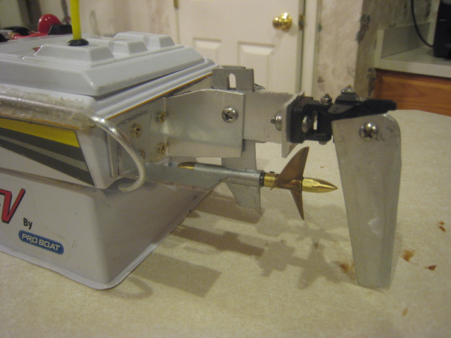

hi, its late and im about to go to bed but i wanted to post some pics of the mini-v before i go. real quick specs, octura prop, strut, flex shaft, and drive dog. 3000kv brushless, mamba 25 esc, 3 cell lipo.
i will give more details soon when i have more time to write.
wish me luck, its almost done and i should be able to test it in a couple days.
john

that hardware is way to big for that boat....Looks like the whole back end will sink when you put it in water...
Nice work just the same.

hi all,
i was kind of thinking the same also about the weight, but i wanted a drive line that would take any amount of power that i can squeeze into the boat.
i just made a test run a couple mins ago. when i put the boat in the water, the waterline rests right about were the servo rod exits out of the transom. the prop churns longer now before it bites but once it catches its planes perfectly, and the boat is very stable. i had a octura x427 prop and 2 cell lipo for the 1st test just to make sure that everything worked ok. it went at my best guess about the same speed as the boat did when it was stock running on a 3 cell lipo. after 10 mins running motor and esc were not even warm, so since it passed the 1st mild test, next i am going to step up to a x632 prop and 3 cell lipo. the prop change and extra cell should at my best guess double the output watts of the drive line.

Spicedcrab, what hardware is that? Is it a set for another boat? or did you fabricate it? Details are much appreciated.

hi,
i got a longer video today. we moved the battery in front of the motor but this made the center of gravity to far forward, so we taped some foam on the front third of the hull so it made a step, to see if it helped with the new CG. we made a longer rudder to help keep it in better control. we added a foam piece on the top of the boat to see if it will self right itself. i think the step and center of gravity made it a little slower, it didnt seem as fast, even so we could still not give full throttle and keep the boat in the water, during the video we hit full throttle a couple times for a second or so, mostly we were throttling it to try and stay in control.
here is the video; http://www.youtube.com/watch?v=H_l7QkR3ZfQ
wheelnut, i will get the stock numbers of the parts i used for you, some was bought, some was fabricated. more details to come when i get a chance to look up the parts.
john

She's real fast, I see you are having the same problem I had with my Gecko, keeping it in the water. Trimming the trim tabs down a bit might help. Also maybe change the angle of the strut.

wheelnut,
i bought all the parts at www.offshoreelectrics.com the strut is the octura alum for 3/16 shaft, the flex cable is .130 octura, teflon tube, alum tube over that inside the boat, the prop shaft is 3/16 turned down to 1/8. the brackets are home depot alum angle cut to length then drilled, the rudder bracket is the stock mini v strut (cut off) and then a single bolt (so it flips up if anything gets hit) holding the rudder that was cut out of the alum angle. the motor is a motor max 450TH outrunner with no cooling, 3cell 1650 lipo, mamba 25 esc (with cooling)
as far as the strut, do you suggest changing the angle down more, or lowering the whole strut deeper, or both?
thanks,
