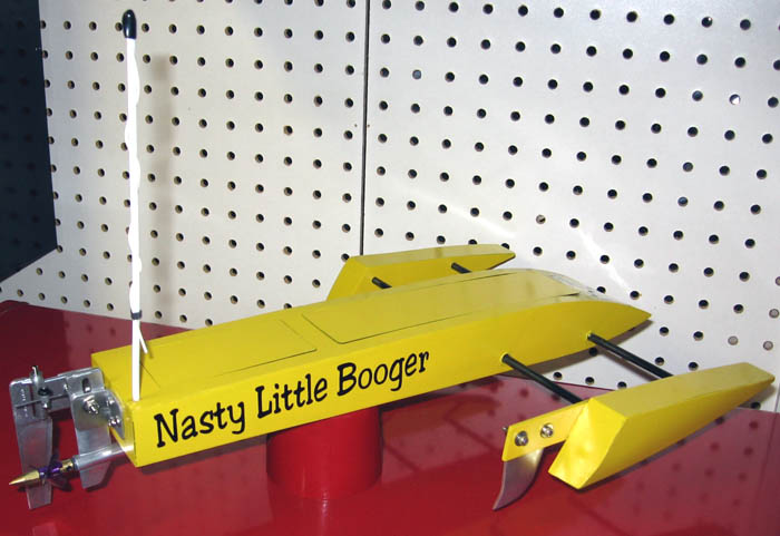

That all depends on what you mean by better ?
My Renegade Rigger weighs in at 13 oz. WITH the battery ready to run and will run circles around a SuperVee 27. Took a little tuning and you need nice water but she FLYS.......tons of FUN !
