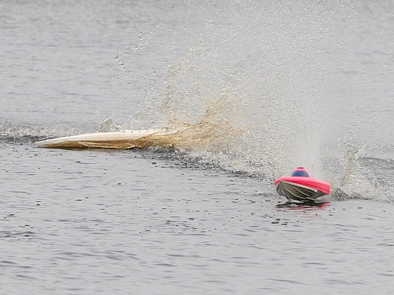

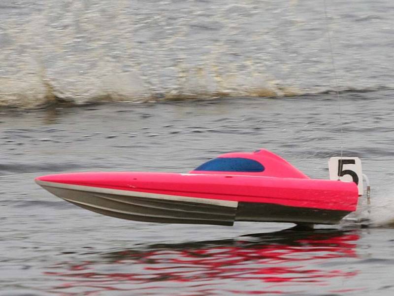

Hi Spicedcrab,
My son sent me a couple of pics to give you an idea how far on the edge we drive our Flash on a 700 motor and 14 cells.
The pics were taken at the 2006 European Championchip in Moormerland Germany.
The conditions were quite 'demanding', a lot of wind and very choppy.
Regards, Jan.
