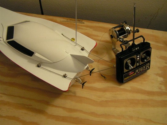

I run GAS boats but I have an EP Racing boat that I use for boat retrevials. I buy these boats off Ebay for a song , they have great value for retrevials. I've bolted an outrigger to the deck that hangs off the back of the boat. A fishing line is attached to that. When a boat is stalled in the middle of the lake, this guy go'es to work.
The boat comes stock with an 1800ma, 7.2v NI CAD battery. Some days I do a lot of retrevials and the battery won't hold up. I have since switched over to 3000ma 7.2v NIMH battery from Tower Hobbies.
I have a Piranha peak charger from Tower that I've been using to charge before I go to the lake. I have the charger set at 7v, with a 3amp charge rate. After a couple months, the battery is toast![:@] Am I using too high a charge rate? I was at a battery demonstration a while back and the guy said you can charge NIMH's at 1amp/1000ma. Is this too much? Why am I frying batteries?? Thanks, Brian

Maxx, These boats have dual 380 motors. There is no variable speed, it's full blast or off. When doing a retrevial you drive the boat out around behind the stalled boat, stop the boat, then reel both boats in. I use a 10" steel leader on the fishing line. That hooks into the rudder when pulling the boats back. Don't really see where the motors would get hot, I'm running the same voltage that the boat came with. I've been using this setup for 4 years now. I call these boats, "throw aways"! If you let them sit out in the sun, the cheap plastic will get brittle, cracks and leaks form after that.
Time for a new one! LOL Brian

Maxx, Look at the pic up top. I'm not towing anything. Drive the retrevial boat out - make a half circle around the stalled boat - turn radio off - reel both boats in - done deal!
Brian
