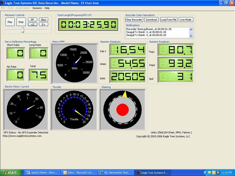

History: When I started with my project last year I made a number of mistakes. But in the end I did reach my goal of over 55mph with my Titan 33. In getting there I burned up a new set of NiMh batteries and also lost a set of LiPo’s. – not cheap…
Today’s goal is to run in the high 40’s and be reliable. And so I bought an Eagle Tree System to monitor battery and motor temp., amp and voltage and motor rpm.
As part of this “post” I thought I would share some data… and get some advice.
At the end of an 8 min. run the LiPo batteries are at 130 F and the motor around 100 F.
I think 8 min. is pretty good when running at around 30 mph. So my though is to cut the run time to 5 min and up the speed to 47mph. If you look at the graph you can see the temperature in the LiPo building, it’s the yellow line.
Draw at 30 mph is around 57A (I have another run around 42mph at a draw of 72A).
Motor speed is around 20,000 rpm (10xl).

I would use both a GPS and the ET data recorder to find the fastest most reliable set up. ( Prop Selection ) No one here is going to be able to accurately tell you what prop would be best. The data you collect from those tools are great - Use them to your advantage.
Also, I would use the under drive gear ratio as the hull is a bit big for the motor. The 8XL or 10XL on 5s should be decent enough. Now start testing props!
I wouldn't mind seeing the graphs and comparing for the props you use
Ryan
