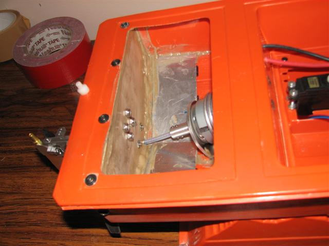

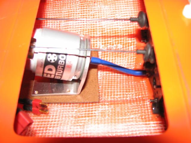

OK, I got the esc and motor and mounts.
I got the 700BB 8.4v and a motor mount.
Now how do I mount the motor mount? screw it in through the hull? epoxy it to the hull?
also do I need to reenforce the hull, and how would I do that?
thanks

Yeah just epoxy it to the hull. I don't know how weak the hull is on the SH so I don't know if you need to reinforce it or not. If it flexes alot then you should. To do that you can lay some fibre glass down or get some carbon fibre sheets and epoxy down or a cheap way is to get a plastic "for sale" sign from your local home improvement store an epoxy some pieces of that in.

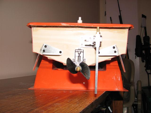

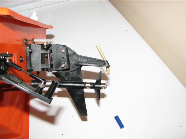

Old 12-26-2007 | 11:32 PM
Joined: Dec 2007
Posts: 102
From: surrey, BC, CANADA
Default RE: Super hawaii help please

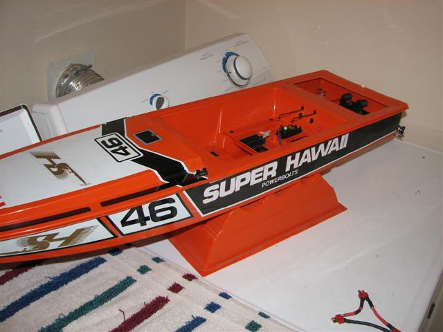

OK I got some pics.
What angle should the prop sit at?
the turning stablizers look wrong to me, how should they look?
I will be adding a peice of alumanium with the motor mount mounted to it in the bttom of the hull.
Just waiting on a flex shaft and flex couplers then I can mount the motor and give it a try.

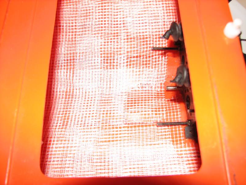

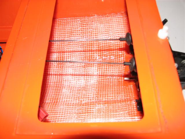

Old 12-26-2007 | 11:45 PM
Joined: Dec 2007
Posts: 102

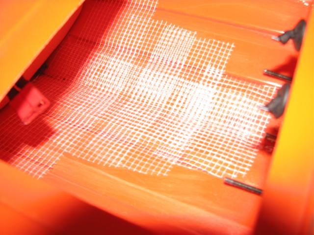

Here's some more pics, this is with the epoxy already dried and more of the prop angle, also this is how the motor will be mounted.
The blue flex shaft is just some silicone hose, just so I can get a good idea of how it will look.
the mesh tape is just that tape with a sticky side, and the epoxy make it alot stiffer. I will be epoxying in the plate that the motor will mount to, the motor is just sitting on a piece of wood, that is were the piece of alumanium will be with the motor mount bolted to it.
I would like to know what you guuys think of this setup and where I could improve it.
thanks

I'd go to the postings on Mini-V and get a better look at out drive.. Now for me i'd put motor further ahead, across the barrier and put a stuffing tube in and take out all the out drive except the plate at the transom. Also go to Jeff Wohlts Rc boat and check out his SH . I did a Mini-V but kept outdrive. I put a .98 cable in and a 1/8" cable shaft put 5/32 brass tubing to help support the cable shaft. Now at transom the stuffing tube has teflon in it to keep water out + cable can flex with outdrive for turning. Now when using cable, a guy can put oil on cable and put GOOP right at hole and let dry but won't cling to cable. I bet you confused. Trim tabs should be level .I just completed a hull ( just hull and topper ) just about what you are doing. Now it was a Villian EX at 30" long. The Grauper 700-8.4 has more rpm like 1745 and the sc has 1470 rpm but can run on 16 cells while 8.4 runs best at 12-13 cells and a 440 prop carbon fiber.
Old 12-27-2007 | 07:37 PM
Joined: Dec 2007
Posts: 102
I've decided to get rid of the stock out drive and replace it with a new one. I'm not confused about the GOOP stuff I understand what you mean.

UPDATE ON THE BOAT
I have gone to the Speed master hardware
I removed the mesh
motor is mounted
back now has a .5 inch thick peice of wood
