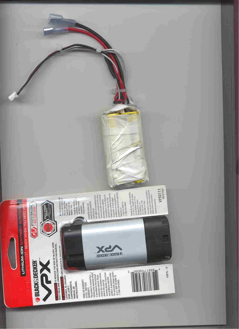

I can not use LIPO.
I have converted all my planes to LIFEPO4 ---DEWALT -----Black & Decker PVX .
Into boats again. Shovelnose only.
Planes have well estabilished WATTS / POUND ratios covering anthing from Cubs to racing.
Boats are a different land to me. Are there general, watts / pound, for small Shovelnoses.
Scale running only is primary goal.
Most important. Where is a COG on a boat like this ?
I will post some shots of the batteries and chargers that are, for me, idiot proofed.
Rich
