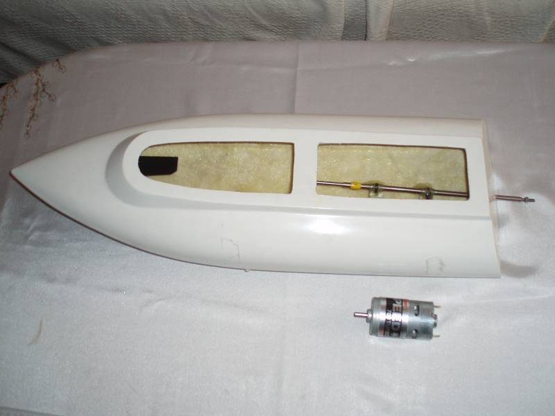

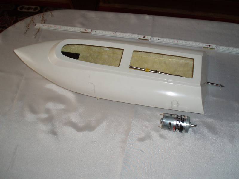

take a look on my new project. A fiber glass hull with lenght of 650 mm. A piercing prop. Motor 700 Speed Garupner ( the old version produced in Japan, not in China ! ).
I can't wait for the first run!
Peter
Peter

I tried to put on forum two pics of my last project - something went wrong and I these two pics are not seen.

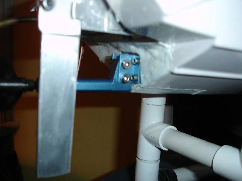

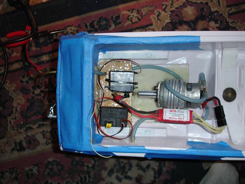

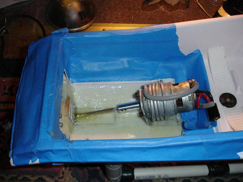

I dont have an all in one hardware combo. I made some parts, like the rudder hardware. It uses a Aquacraft sv27 strut, but this is the basic arrangement of them motor in a mono.
Some pics of when I was building her. She has a 700sc from offshore electrics, uses a graupner k-series 42mm. It's a Traxxas Villain EX hull and runs on 16 cells, 19.2v. Uses brush and can cooling.

tried to put some pics of my new boat with 700 motor but something went wrong.....

this is my last project. Fiber glass hull with 700 motor. 12 v. I built model of that kind using the same equipment few years ago. Now it's time for remake....but some changes will be added. No water cooling. With carefully chosen prop this hull goes like a bullet.
