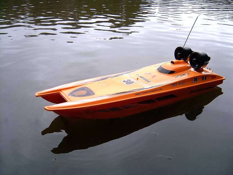

I'm going to take a wild guess and say this is the admiral ebay boat, with twin vector thrust 540's. If so, search the site for ebay, boats, toy, admiral, NQD...... this will point you in the right direction. If not, well we need to know what ya got there.

I am by no means the most clever person here but I can see few flaws with the boat that you have, given the link to the addvertisment.
Overuse of the word professional is a give-away to a nqd type build.
A single prop and "vector thrust" do not go together.....do some reading and all will become clear.
A single 550 and 35 mph+ is a long shot for a boat that is over a metre long....reaL long shot !
35 min run time with a 3600mAh pack on a 550 for FE is a non starter !!! End of !!
o.k so I have bagged the add for the boat that you have bought, all is not lost.

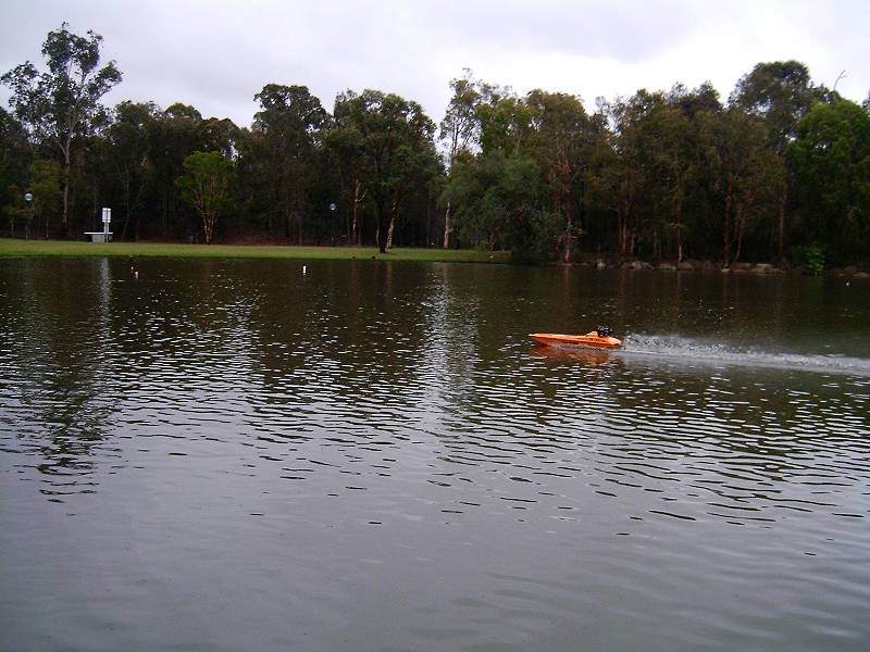

Sorry to create another NQD Admiral Question , though i am wondering what this specific boat has for an Electrical setup , as with the boat i own , i am ( at the moment ) not fussed by its lack of speed or pedigree , just using it as a test bed to learn about my new hooby with . Would like to hear from somebody that can tell me what amp motors i can put in & battery setup ( e.g Dual 7.2v NIMH 4200 Parallel battery ETC ) without frying the thing . Have got a bit of a knack for tinkering & soldering , just unsure of electrics with the Admiral ??? , Many Tars ......

Thanks Ivan , looking at a new boat at the moment . Though if i can keep this big cat going as a side interest , i will !! . Maybe use stronger Batteries such as 3S Lipo's on my new project 5000mah , while allowing them to power my admiral at times . The Admiral that i own has provided a good start in my new hobby , with little fault for over three months ( 15 outings ) .....

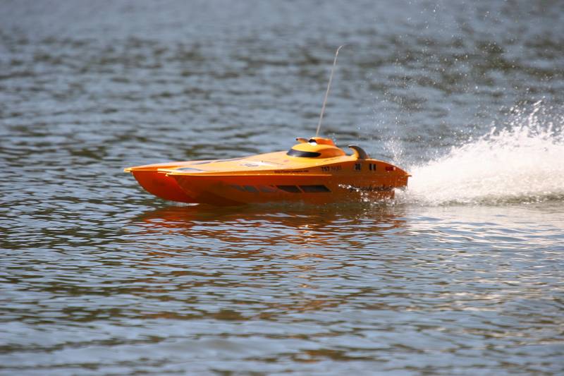

RE: RC motor ?
I dropped the SV27 motor/ESC into the Admiral a couple of years ago. Went OK on 4s Lipo & a 445 prop. Now it's my rescue boat with this modification for a bit of a laugh.
