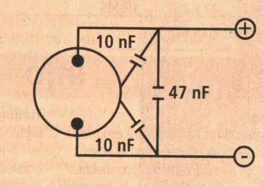

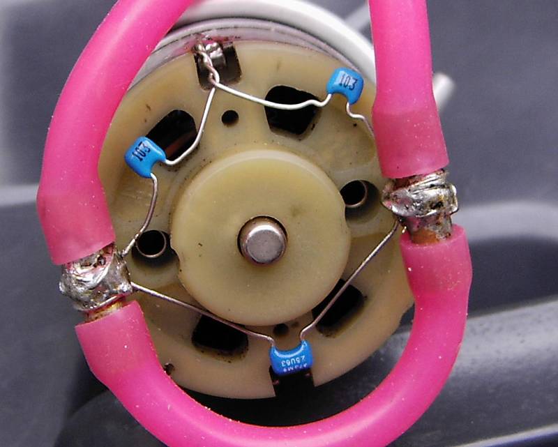

Hey hows it going guys... ok here's the thing I have a Ebay Boat called Wild Seeker, Basically its a "knockoff" of the Kyosho Sunstorm 600. Witch I found out after I got it home and started to learn more about RC Boat's cause this is my frist one we'll at the end of the frist season I blew the ESC lol.. its all cheap no name stuff anyway,, So I bought a new DuraTrax Streak ESC.. It was a good price and I needed one that was kinda small cause theres not much room in the radio compartment .. we'll in the review it says Units Low FET Count ?? but I have no clue what that means ?? so if anyone knows let me know please.. thanks .. So now I need a new Motor cause the old one had it. I was looking around and seen a Kyosho Aquaspeed Motor that was nice but no one had it in stock then I came across this GRAUPNER SPEED 600 BB 7.2V Motor so I orderd it. I didnt get it yet I was wondering If anyone has this motor ?? or heard anything about it is it a good motor and is it a good choice for my boat its 24 long 7 wide.. and the ESC rate is 300 Amps it says and the boat is a Direct Drive and I have 2 prop's I been useing a OCTURA X431 plastic one that came with the boat and I have a metal OCTURA X432 but with this one, The shaft really wobbles alot when the boats out the water and I full throt it maybe I shoudnt use this one at all "what u think ?? We'll thanks for you time.. Shaun !!

Cool.. yea thats the boat i only got it cause it was free shipping I only paid 94 bucks with tax.. Thanks guys so much for your input I got all those Capacitors and i have the big one for that Schottky diode .. so when the motor gets here i have to put this all on.. so I have 3 little ones I saw someone put the 2 on one side of the motor and one on the other side is this right?? plus the Schottky so its 4 alltogther on the motor do I have this right im sorry im really new at this u'll have to work with me ..lol sorry but i think I got it.. POMPEBLED I was just looking at the shaft and your right its really loose Maybe I can get a little piece of wood or should I get a Piece of metal and wedge it under it so it wont move .. i knwo what u mean I just have to find a good way to do it.. im goona look around and c if anyone else did it so I can get idea's how to go about it.. thanks guys so much for you HELP.. wish me luck..lol
