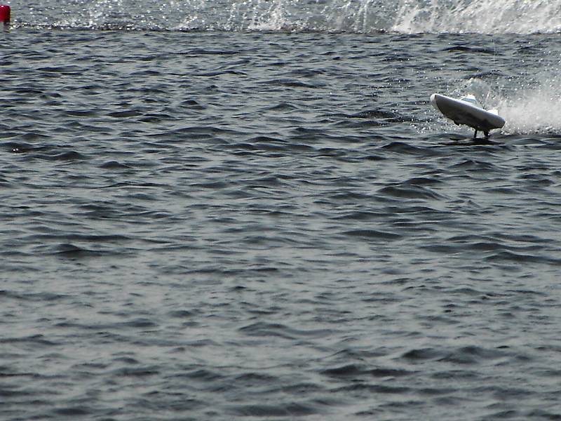

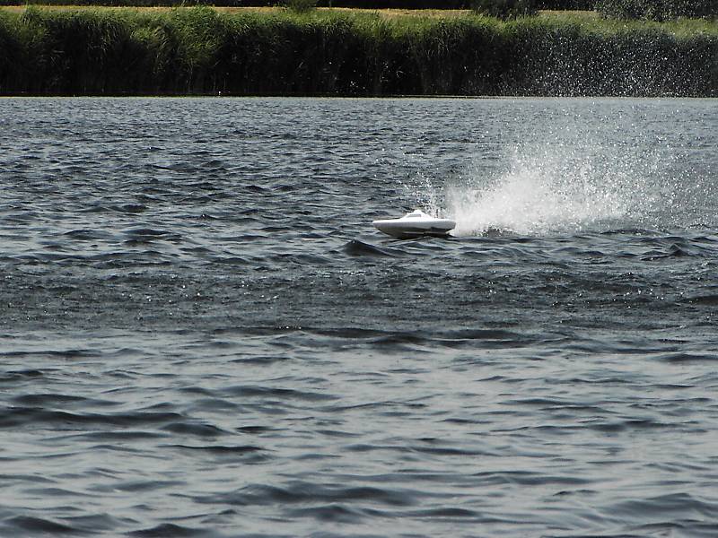

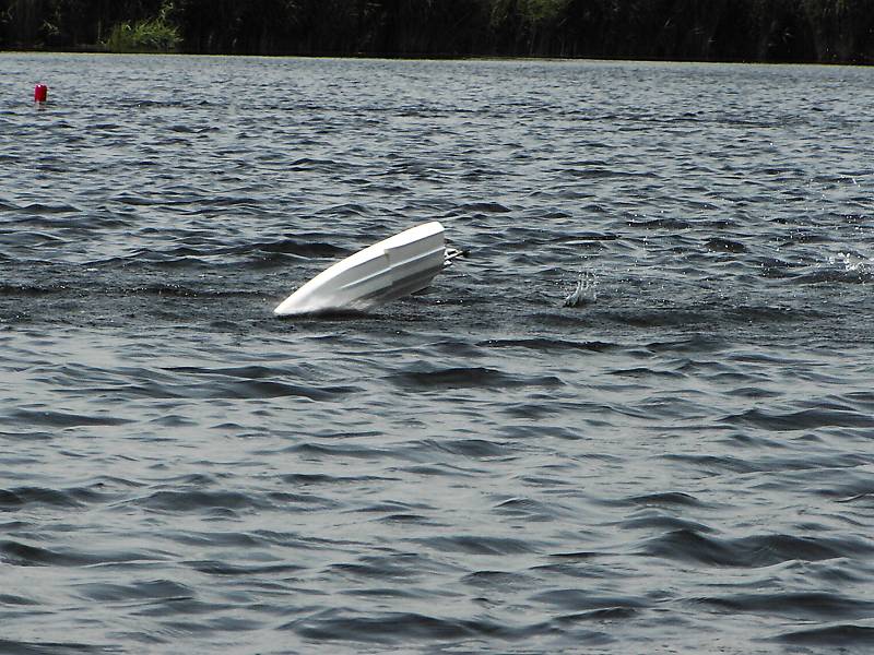

Hi benhojo,
A cat may seem better, but once on the plane, they flip easy on rough water and float very stable, upside down...
I'd advice a deep vee, preferably with a floodchamber to make it flip back up.
Sadly there's no RTR with this feature, as far as I know, so you would have to add that yourself.
If you expect conditions like in the pics, definately get a selfrighting monohull.
Regards, Jan.
