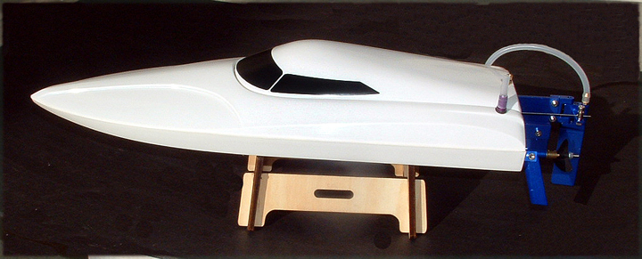

Default RE: What does it take for a hull to be self-righting?
Or you could go with the Velocity...it's self-righting out of the box (w/o a flood chamber).

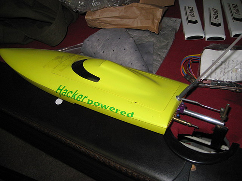

I don't know 100% but, it's almost 18" long, stepped on the bottom and a typical looking deck. ? You can see I bought it in the rumrunner swap shop 2 weeks ago.
