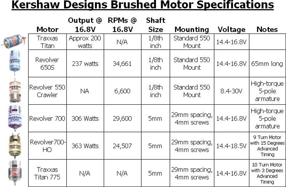

Heres a motor chart from kershaw designs............check out the 650's!

Had a battery pack explode yesterday, on my first pass! made a fast pass near shore to check cooling flow and pow!!!! scared the crap out of me! put in another pair and it ran fine...
I also sent a request to Kershaw about the 650 and my esc... I ordered the 650's a lot of revs for little money......gotta try them.

Why not go with two 700s?
Old 12-24-2009 | 08:47 PM
rebuilder's Avatar
Joined: Jan 2008
Posts: 1,917
From: Ark, AR
Default RE: Traxxas EVX2
The EVX2 wont be able to handle two 700's with the huge constant current draw.............it'll heat up quick and start to cut out.
