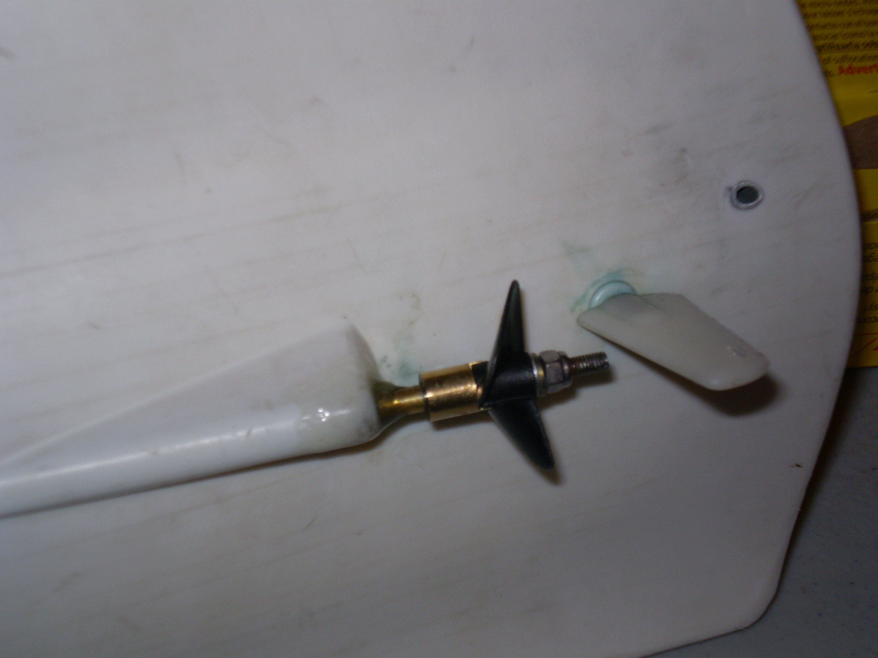

I have recently installed a brushlesss system in my Aquacraft Reef Racer 2. The motor is 2700 kv, and the battery is 3-cell li-po.
It went ok until the half throttle, but over the half throttle, it spins out to the right hand side or flips over.
Thus, I added some weight in the back of the boat, making it sit deeper in the water. Also I shortened the water pick-up from 5 mm to 2 mm to reduce lifting-up effect by the water pick-up.
Now the boat runs ok until 80% of the throttle, but over 80% of the throttle, it begins to badly “ROCK”, and at the full throttle, it spins out or flips over.
I would like to hear good advices from experienced boaters to solve this problem. I am now frustrated.
Thank you for your attention!

Obviously overpowered. Put the brushed motor back in. Or use 2 cell lipo

i agree, to much power and the torque steer's kicking it over,  try 2s

try a smaller prop, never such a thing as to much power in a boat..
also make sure the rudder and strut are set correct

The water pick-up of this boat is not on the center-line. It locates a little off from the cneter-line on the left hand side.
If removing this water pick-up, and installing a new water pick-up in the center-line of the hull, does this help?

not really going to help only if it gets more water but at the same time you don't want to cause more drag..

I don't know the anatimy of the reef racer but I think he might be talking about the rudder.

i've had a look at the RR 2 and the prop and rudder are below the boat, could you post some photo's so we know exactly what your talking about please

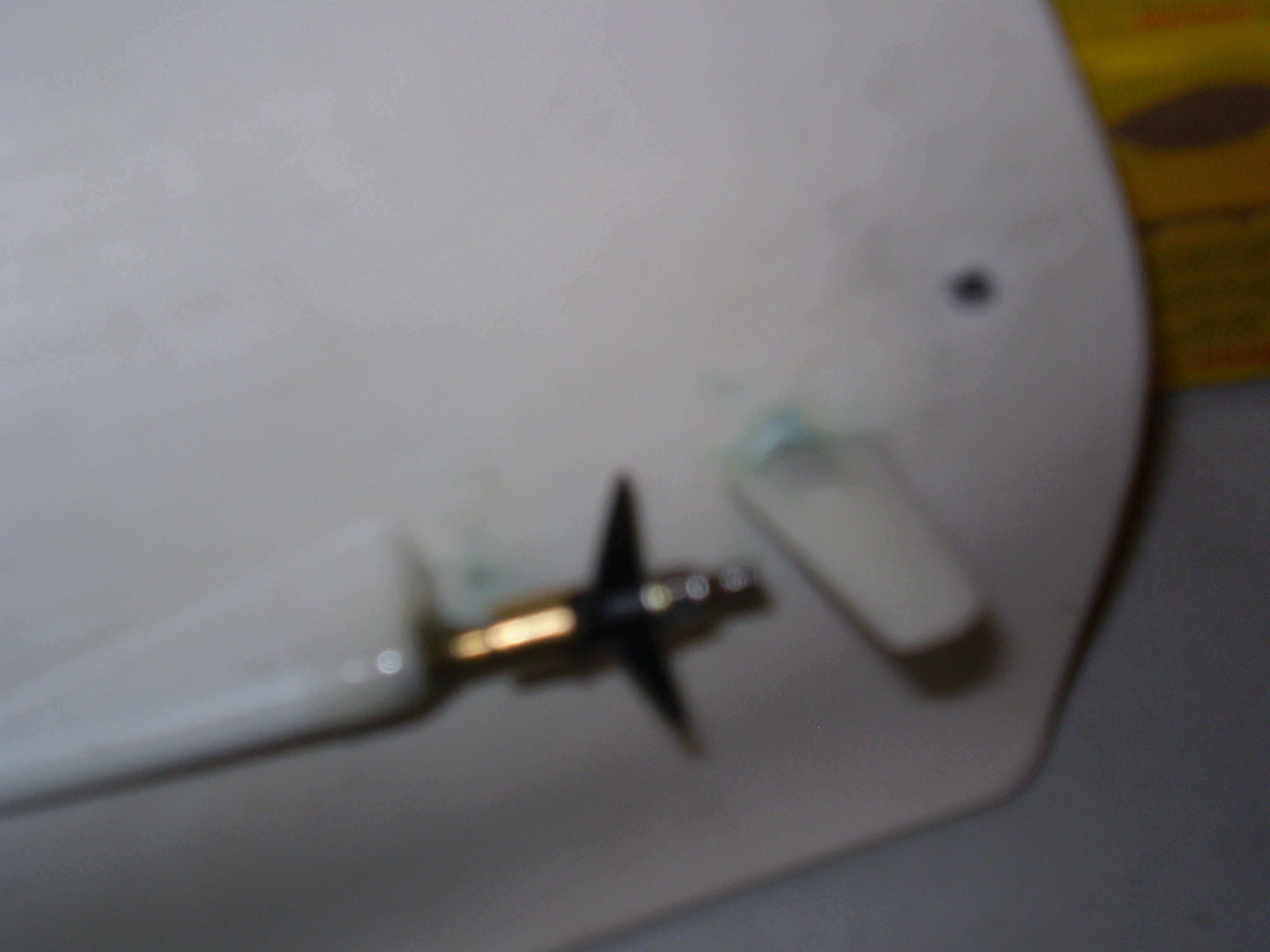

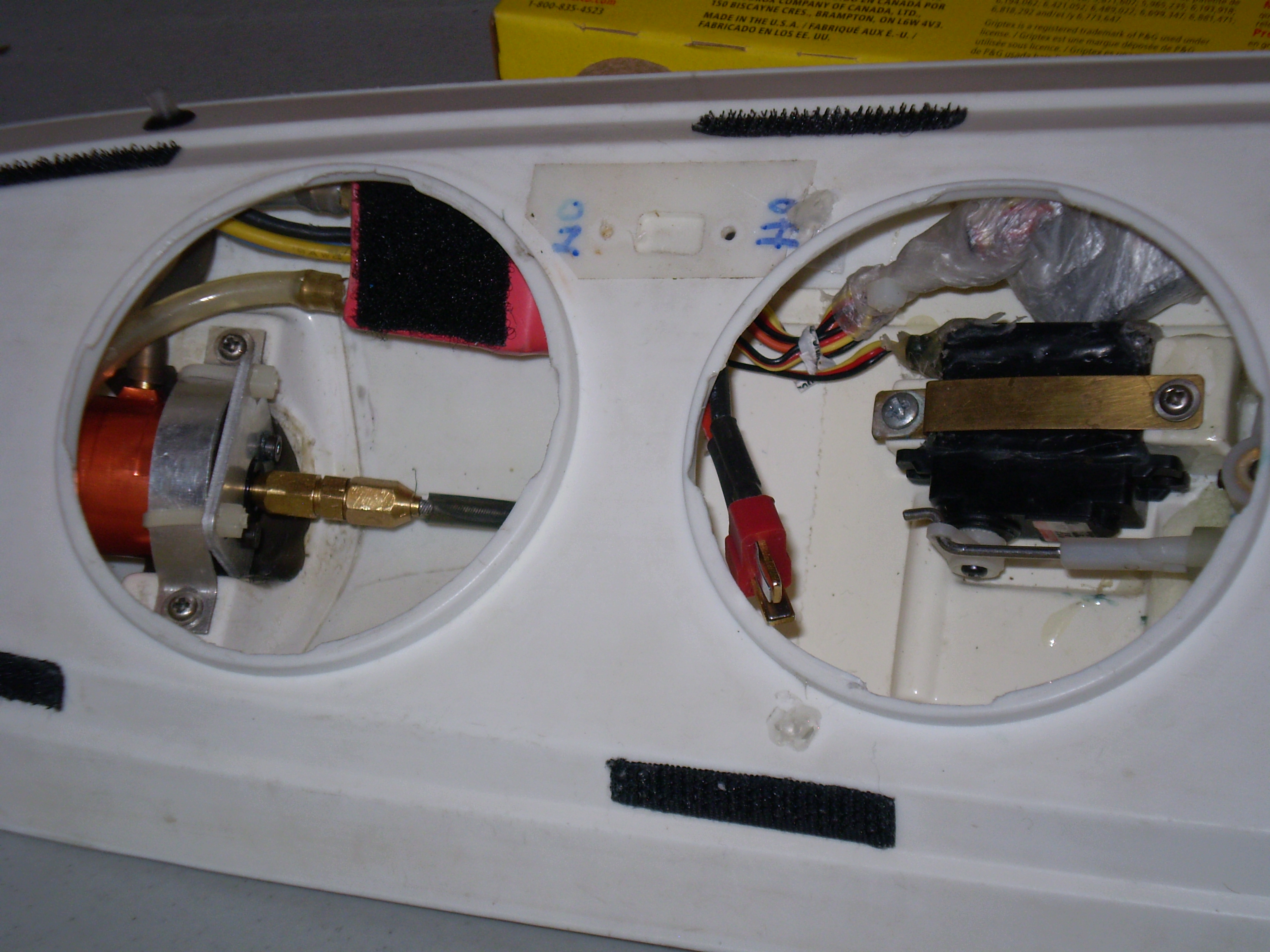

Here are the pictures! This time, it seems to work.
Thanks!

The first picture is not clear. Here is another one!
Your advice will be appreciated! Thanks!
