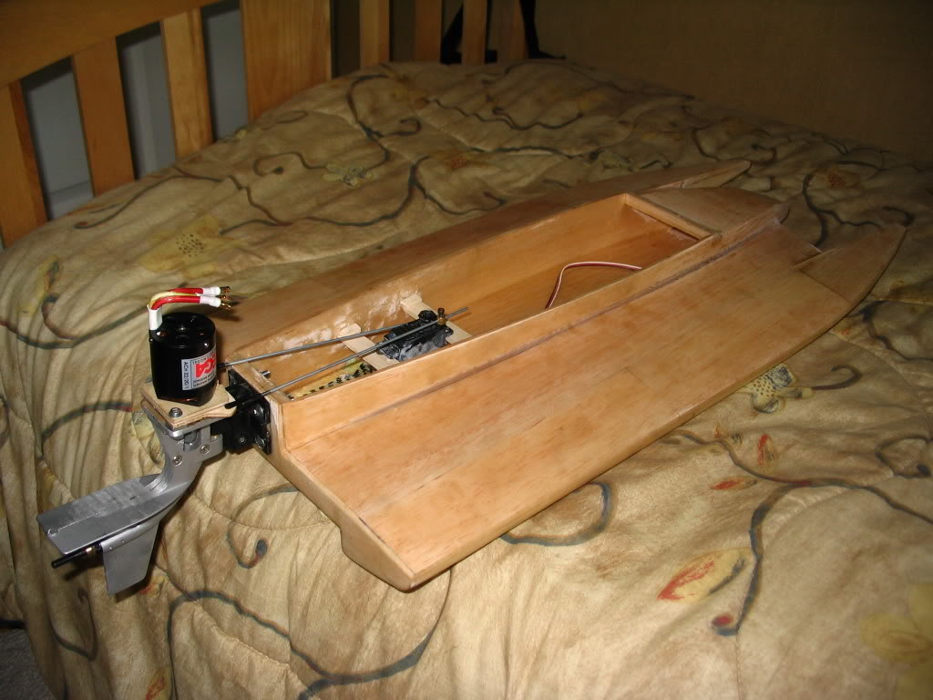

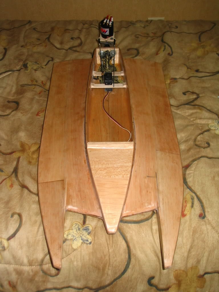

here is my custom STV style hydro.
its 32 inches long from bow to plate.
tell me what you think.

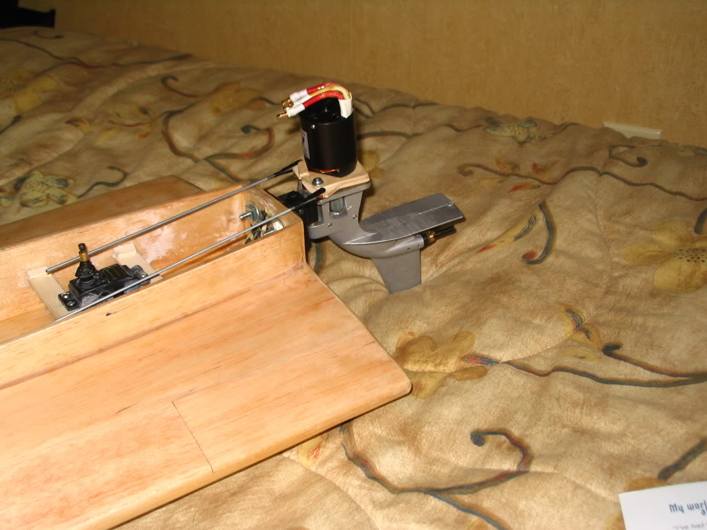

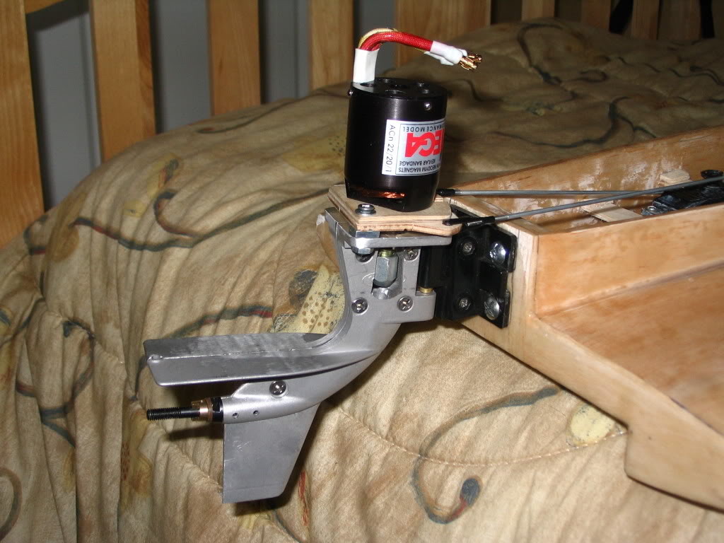

i have got a K&B 3.5 CC lower unit. it still need a bit of work to it to make it super light and very stream line.
it will run as a 6 cell boat it is very light and pretty cool if i say so my self.
Ryan . eat your heart out.

It's way bigger than I originally thought. What does it weigh?
ryan_t888 08-29-2007 12:01 PM
RE: STV OPC
That's awesome! The only thing I'd change is that black can over to a 3.5cc or a REAL engine. haha, good job man. Keep me updated on this project.

That's not really considered a hydro is it. That's going to ride on it's tail. Did you design from scratch?
CadillacDTS2001 08-29-2007 12:25 PM
RE: STV OPC
i have no idea what it weighs.but it will balance out on a pack of my GP3300's
so i guess it weighs the same as a 6 cell pack of GP3300's
yes there are no plans for it all built off balsa.
it will be faster then a 3.5 CC any day i bet you. and if it's not then i will run 12 cells.

I seriously would dump the K&B prop shaft and go with the nitrowatersports rebuild kitt. The bushings K&B used are crap and wears out in less than 10 - 10 minute runs.

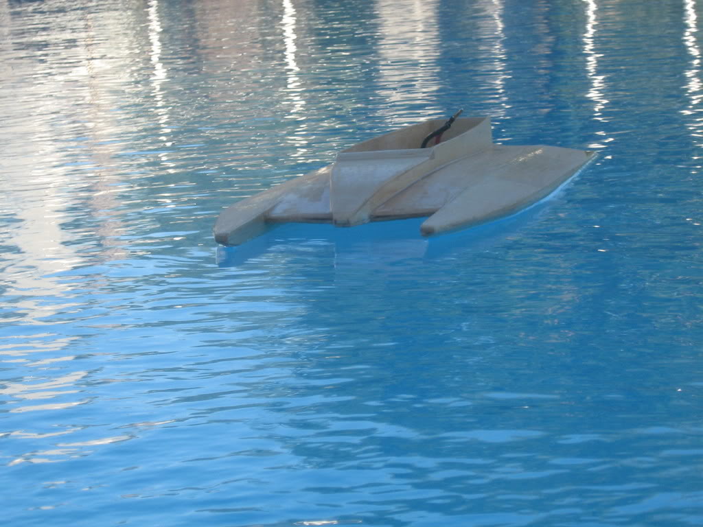

DONE and running. . . well sorta
so i have her all setup and damn she run great for just throwing her in the water
she picked up nicely but was a little hard to drop on the pipe but it did after just sheer power. i never once completely opened it up because it would kite and flip over at literately 1/2 throttle. but at that speed it would be fairly competitive. i trimmed the motor and the batteries as far forward as i can but it will still lift. I flipped it 3 times in one run. when i put the power down from stand still it will pull right up to bow in the sky and then drop on plane like that. i need to keep the boat down. just to much lift. I am very happy with the boat it's awesome.
