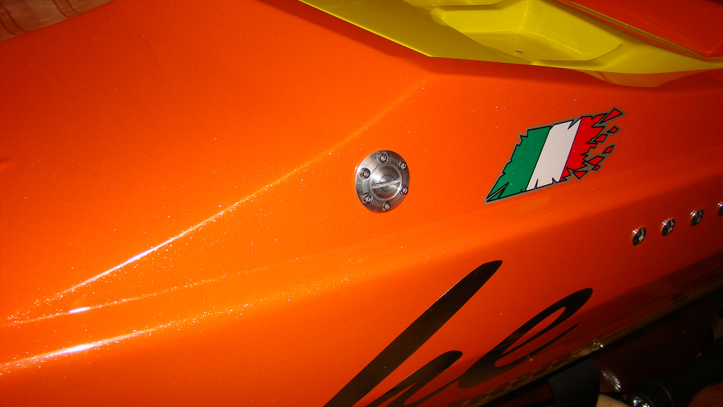

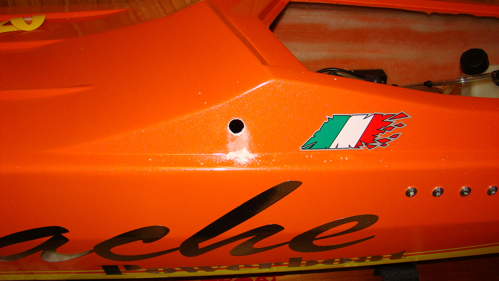

I hope this picture helps with your fuel set up on your 520, this is what I am going to use on my 520 Mart Apache.
Bob.
PS the WHITE LINES are what WD200 send me.
Mario this fuel filler is from Tom Lorenze Germany this is what I use, you will need a hand pump to use this ok.

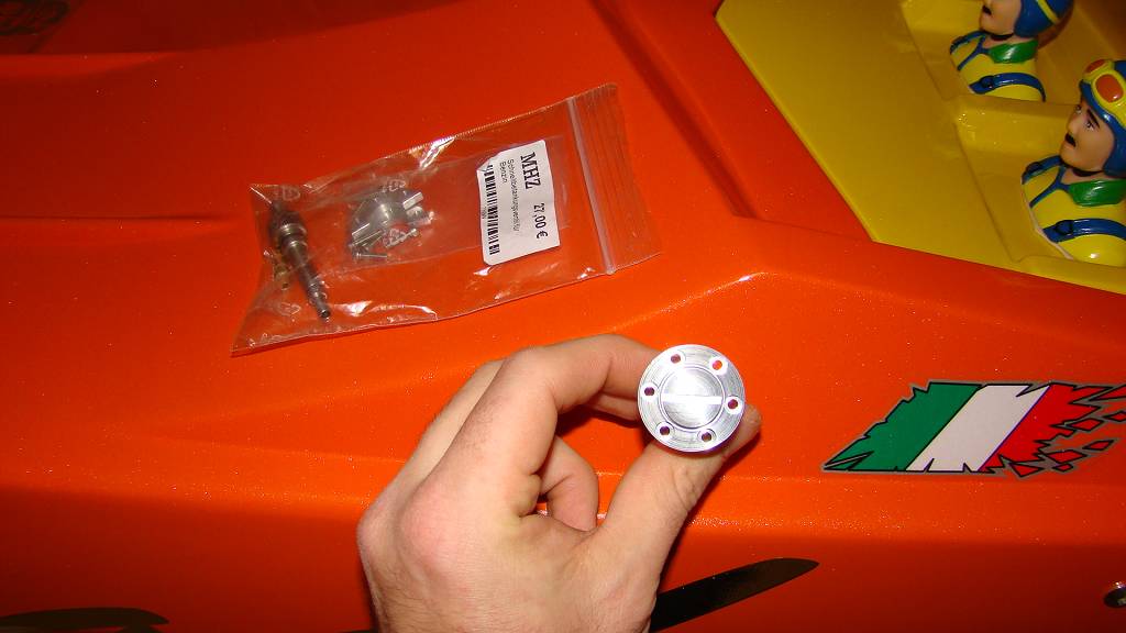

Old 12-10-2011 | 03:46 AM
  #28
Joined: Dec 2011
Posts: 173
From: Porto Sant\'elpidio, ITALY
Default RE: Apache 84
Thank you very much Bob<span class="hps">, i have this plugs (photo) from mhz, but i will need that hand pump you are talking about, where i can get it? do you have it? another question, where do you get that splitter (carb1-carb2)? thanks again.</span>
ID:	1697952   Click image for larger version

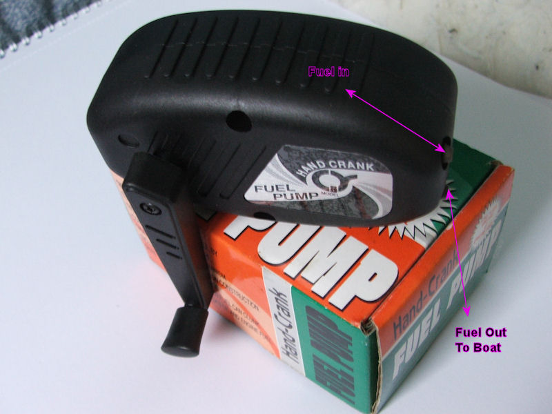

here is a picture of the fuel pump that you need, make sure you get one that is ok for GAS the nitro ones dont use ok, you should be able to get these somewhere in italy but I dont know any shops there !
you must also use 1/8 tygon yellow gas pipe with the pump dont use anything else ok.

Yes tygon is a different material not silicone which desolves with gas.Actually the pumps are the same least the ones ive used are same as the ones the nitro guys use,im still using the same one 4 yrs later but you need to swap the lines to tygon or you can use the clear stuff from the mower shop .
Mart

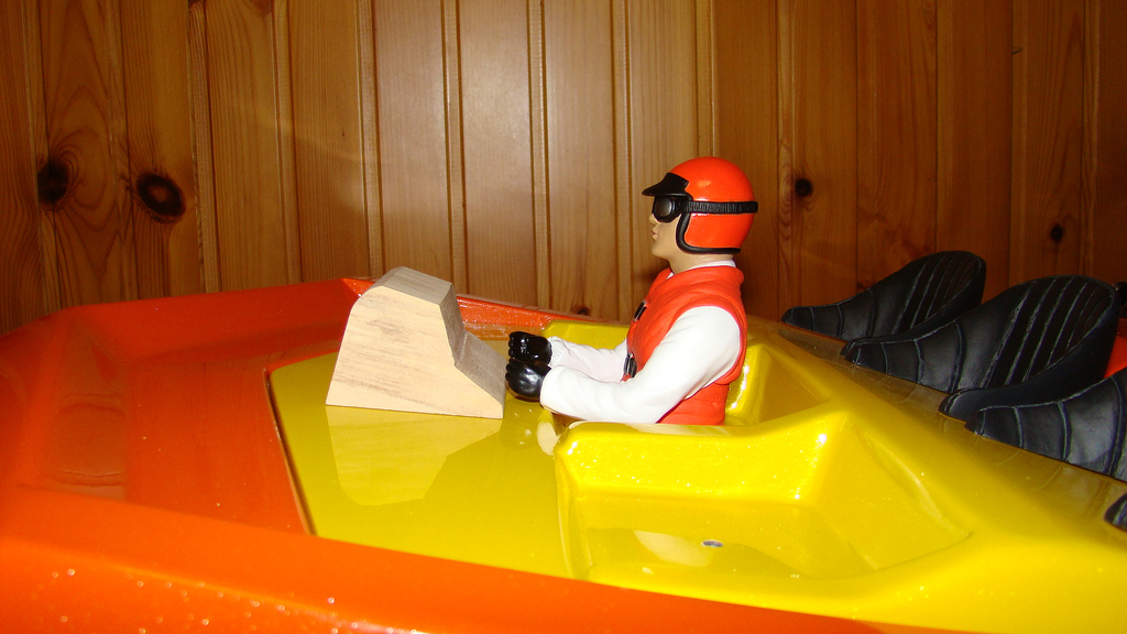

Old 02-27-2012 | 10:11 AM
  #40
Joined: Dec 2011
Posts: 173

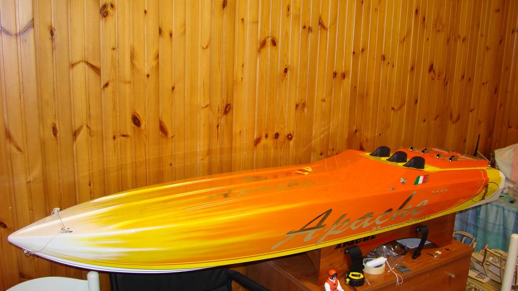

Hi guys, i started with some work in the boat, the first is change pilots and <span class="hps">improve</span> <span class="hps">the aesthetics, like adding seats, <span class="hps">dashboard and others, one doubt i have is if i should paint the seats or leave it black, what do you think? Then i installed one of the <span class="hps">fuel caps and <span class="hps">disassembled all the <span class="hps">sterndrive, now i have to close all the stern <span class="hps">holes ( look pic) what should i do? take it to the body-paint shop? or try to do it myself? if you think that i have to do it myself, tell me what material and putty or fiberglass i should use, remember that the inside part of the stern is a <span class="hps">layer of</span> <span class="hps">reinforced wood, thanks.
<span class="hps">regards

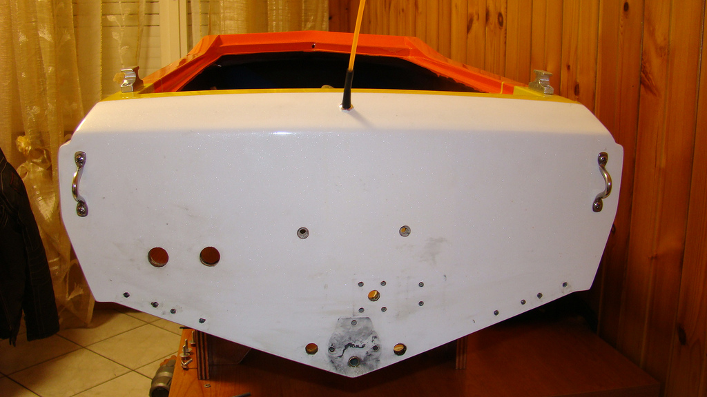

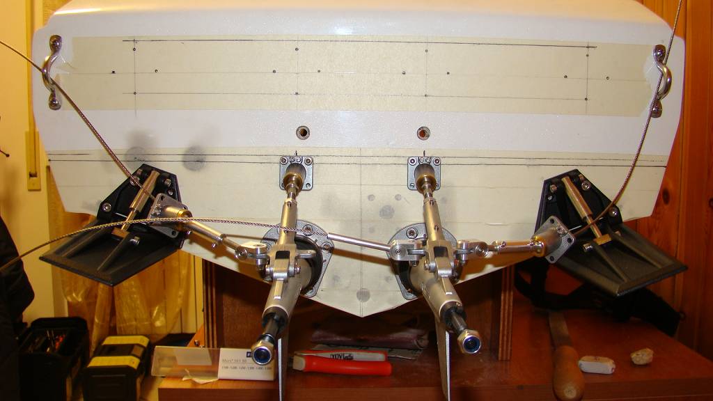

Hi there, some working progress, next step is place the exhaust pipes.Regards

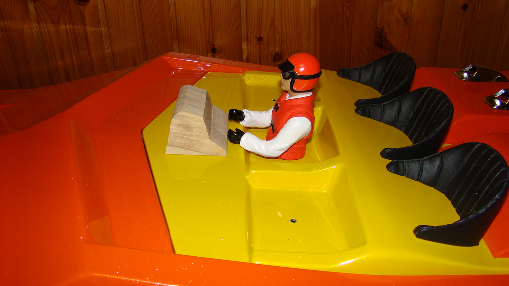

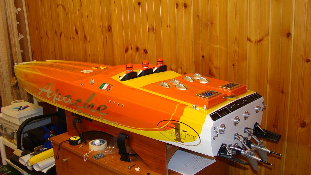

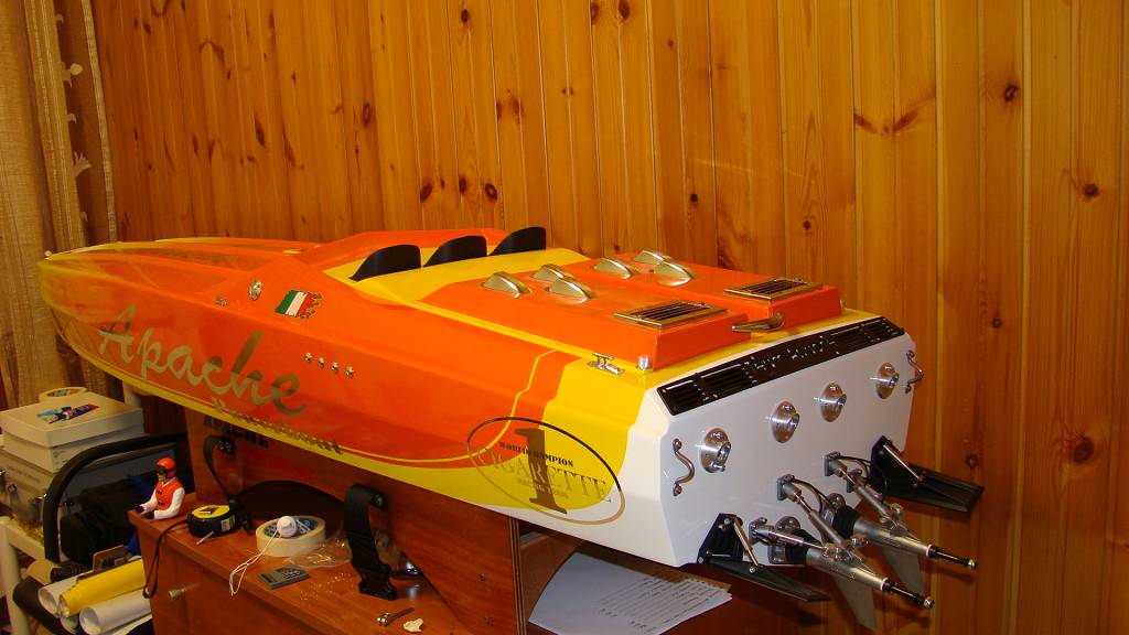

Old 03-23-2012 | 04:17 AM
  #49
Joined: Dec 2011
Posts: 173
Thanks specialk1, these are rcmk steerable drives, or trimax arneson, however they're not <span class="hps">available <span class="hps">on its website and i don't know why, a lot of people are asking me where to get them but i really cannot answer, maybe be someone in this forum knows.
Some recent pics, seats &amp; pilots.
Regards</span></span>
