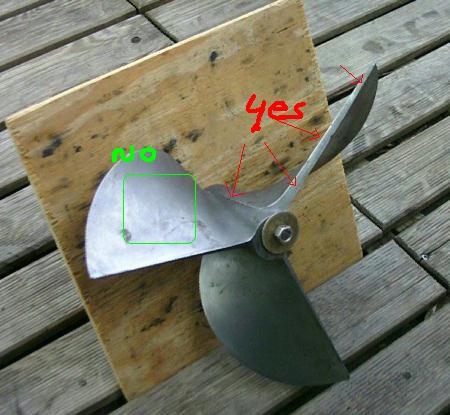

Hi all. I'm building my first gasoline powered large deep vee. Although I am an experienced builder of scale RC Boats, This will be my first attempt at a boat that requires sharpening and polishing of the prop. I have a new Prather 280 made of stainless that I'm going to use on this boat. I aquired it from a friend, and there was no literature with it which might have explained how to sharpen and polish it. So if anyone's got the time to explain the process to me in enough detail for me to complete the job, I would be eternally greatfull!!! Thanks in advance-----JH

Haljmac is giving you Prop Balancing 101. Thats all there is to it. A little here a little there and check that balance as you go.
Here's a photo of a real prop with the help of some Paint Shop.
