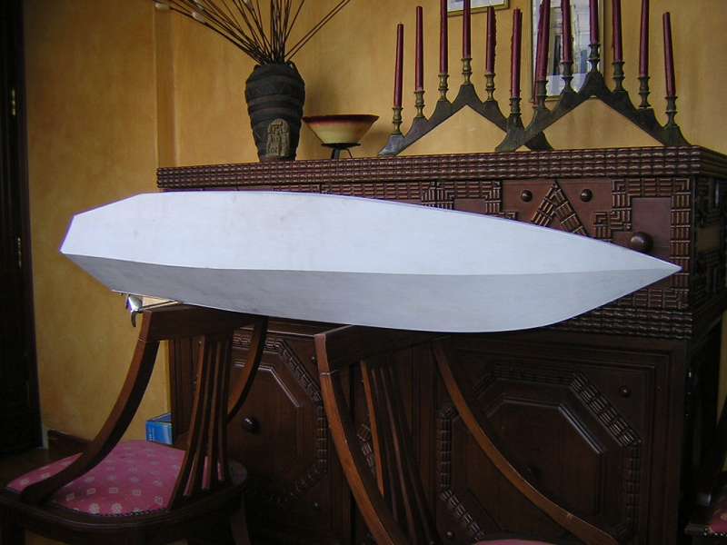

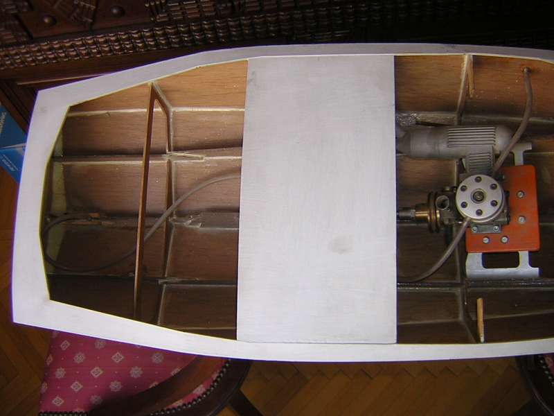

The boat is actually a 48 inch screwdriver... built to scale from plans by P. Simmons.
I got it from a friend who had built it ... just perfectly... still needs painting. (plywood construction). see photos.
He also ave me 2 nitro engines ... Magnum marine engines ... a .60 and a .91 XL
That's why I'm sticking to nitro engines since I have them.

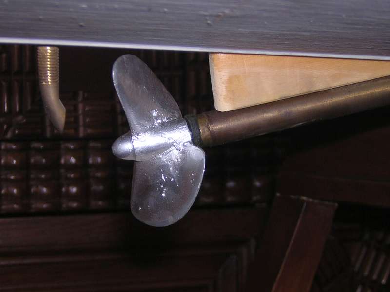

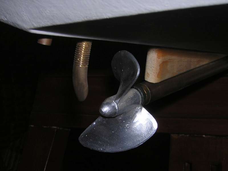

The prop I currently have on the boat (see pic) was homemade in cast aluminium with the .60 in mind... Have no idea what size is it... Do you have an idea how can I figure out it's pitch?
Again thanks for your input.
