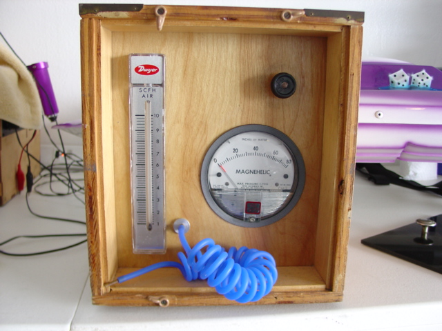

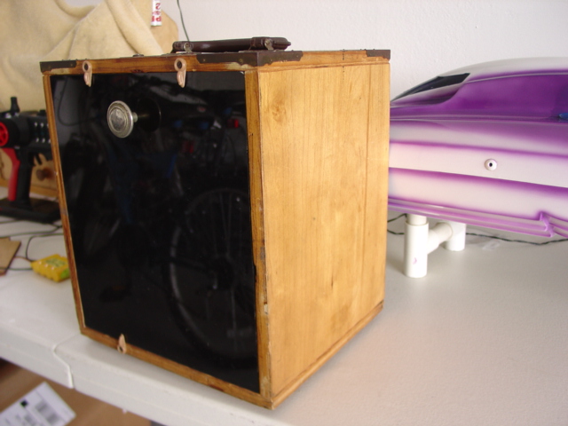

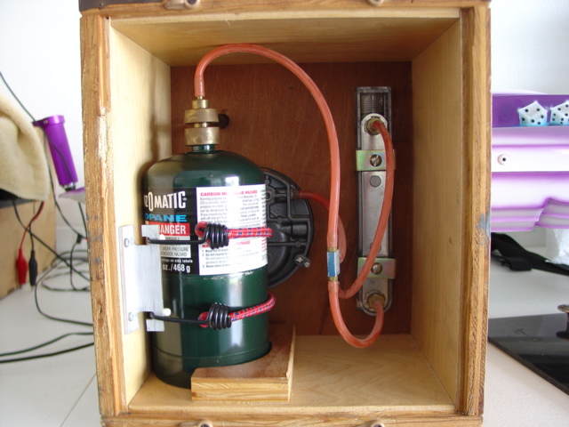

here's what Ron talkin' bout just for an idea, sorry i can't show the back part, kinda lazy to unscrew.

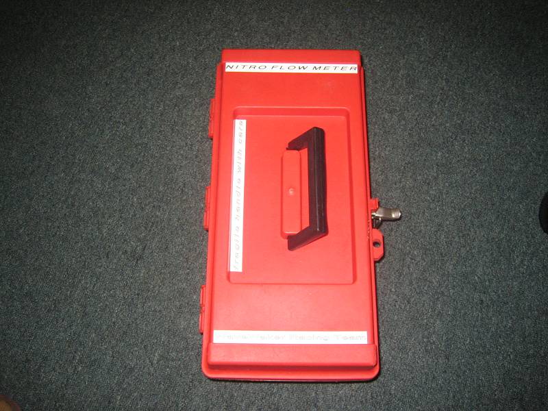

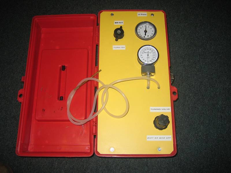

Here are some pics of my flow meter. It was made by Tidewater Engineering and I bought it from a guy that owned a hobby shop.
