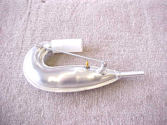

Here Chuck let me share my notes with you maybe they can help. Click on that pic and I have written a general table to look at.
While your thinking, remember when a motor comes up on the pipe its tendency is to go lean, so always start with a fat setting with your starting length, and go through the needle first. Then move the pipe in and go through the same process with the needle.
This is where the third-channel mix is nice.

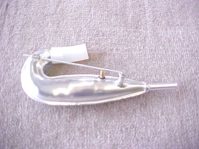

That pic I threw in is one of those copper fitting headers I've seen around. I am not sure where to get them or who makes them.
I would say give it another shot with a longer piece of coupling, and work that needle more. I think with what you said about being too short already, and running 60% nitro, you might have started too short to begin finding it, and its choked on the pipe. Drop a prop size too, get the load off the motor so its easier to tell when it jumps on the pipe.

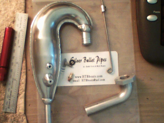

Here ya go.. I used my calipers also and they don't lie!
6.625 root to stinger tube
2.625 inlet tube to stinger.. same
1.140 fattest part of pipe before weld to weld fattest across pipe weld to weld 1.710
1.240 fattest two halves
1.500 mounting post .. center of post to stinger
8.00 overall pipe length.. weld to stinger end.. not including J
3.210 overall width.. header end .625 across J to weld
12.500 overall length .. .625 end around to stinger end (outside)
I sure hope you understand this! Because it sure looks funny if someone reads this.
Looking at the two measurements I would guess you have the HP pipe but not sure.

I knotted one end of a string, and tugged it against the .625 tube end to start, followed it around the outside of the pipe in the flair-bend radius, inch wormed my finger all the way to the very end of the stinger tube and came up with 12 inches right on the button.
Mine is a half-inch shorter overall on the outside curve, .060" fatter across the halves, so it must be the stumpy HP.

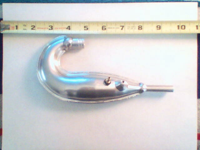

I'll try and snap a good pic with a tape measure with it, maybe you can pick something up that I have missed.
If I knew this morning I was going to be holding a camera I would have backed off the coffee.
This is the squarest image I can come up with and the best focus my webcam can muster.

Your pipe has a bigger and longer J bend. I wouldn't put book on it but I would say its a hp pipe and I'm stuck ith this low nitro pipe.
Maybe all this time this is my trouble. Irwin here I come. I'll take off my Irwin pipe off my other boat and give it a try.
