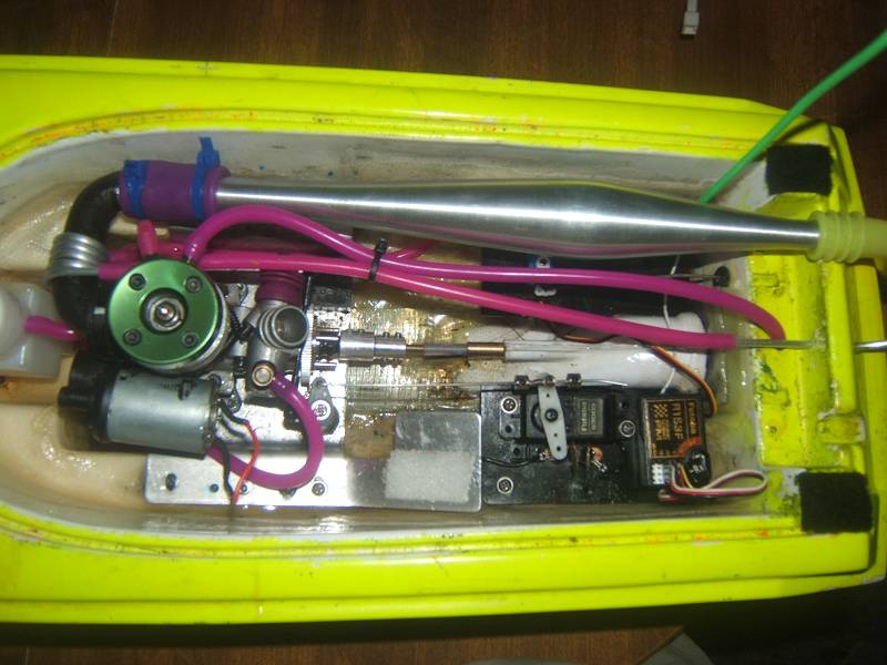

ok after fixing the tank on the nitro jet vee . im still having a problem with it die mostly on the upper end of the rpm . it will run some times on the low end some times it will stall out 5' from takeing off but i thank that has to do with the upper end to . i even tock the tune pipe off and ran my buggy pipe to see if i didnt have the presser fitting in the right spot . still did the same thing . when im running at half trottle it does pretty good but if i give it more it starts cutting out almost like it running lean . i know the fuel system is clean and im starting out at 3 turn out on the carb . also if i dont idea it up before i prim the pump it will stall out im thanking larger flywheel for that im only useing a hpi savage with a 5mm-.150 ose cable cupler . any thought would be great thanks

Hay try to take the carb off and take it apart and clean it out with carb cleaner. You might have somthing obstructing the hight speed needle area? Still sounds like your still on the lean side? I know when my CMB.21 dose that,when I'm trying to go faster and wants to die out/bog on me. So I turn mine out to 1/2 and she goes.

Ok that might help me understand maybe better. It that a side slide carb your using??They can be very tricky to tune in. Be there are very responcive carbs/snappy responce.

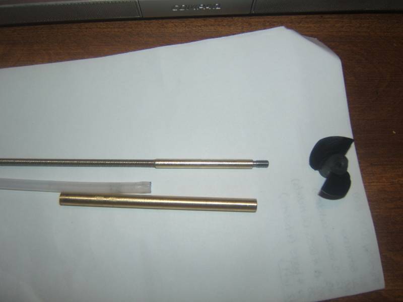

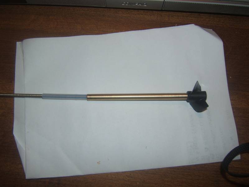

Old 08-07-2008 | 01:42 PM
Joined: Jan 2007
Posts: 1,760
From: PORTLAND, TN
Default RE: i have a problem that bugging me
yepo i tried to load some pics but it wasnt working .

Try like I'd said clean it out.the carb. Had that happend to my vegas with a thundertigerpro.21 buggy BX-R motor. But there another proublem to. We seen guys running car/truck motors in there boat. These buggys motor might not work wright with out timming mods to these motor. Boat and buggies motor are timed differently. Boat motor are under alot more load then buggys motor=different timming curve. Rigger guys,some are using car motor and getting away without not much mods because there not much of a hull to these riggers=less weights=less loads=faster speeds. Oh!!! You might have to sorten that tune pipe. It might be to long too. Car motor like there tuns about7- 7 1/2 -8" long That might be part to most of your proublem too.On my thundertiger pro.21 BX-R the tune pipe is 7 1/2. Whats your tune pipe lenght on your boat??

ok after my last post i headed to the lake for some more test and tune . heres what i got .
first still running the buggy pipe i backed the niddle out 5 turns and started it up " this was with out doing anything but relubeing the flex cable " filled it up im running 20% at the moment cant get anything higher . ok i set it in the water and wow what a diffrence . but still no top end but it wasnt cutting out like before . so i had also cut down some props that was a 3 and 4 blade with less pitch then the stock 2 blade . heres what i got . one a little slower speed and i was hitting the top end but i was airating the impeller . about 1/2 trottle was it after that it just rev out . so that tells me some i need to tune my pipe for a little more upper end torq . to get the rpm up . what do you all thank .
Old 08-07-2008 | 06:14 PM
misshydro's Avatar
Joined: Jul 2006
Posts: 2,925
From: stmarys, OH
Ok hears form what I was told. shorter the tune pipe more topend rpms,but you can also lose the tork power too=have to run smaller props. Most guys on a marine motor at 9" and start cutting them down1/4 at a time until you find that sweet spot. Buggys some start at 8-8 1/2 then go from there.A 37mm prop might be a good starting point? The one prop that was asperating/cavating, sounds close,but you might need to bump up one prop bigger than that one,that might be your ticket prop. I'm running a X437/3 and man my boat moves faster,then my 40mm prop. The 437/3 is a 37.6mm prop size.
