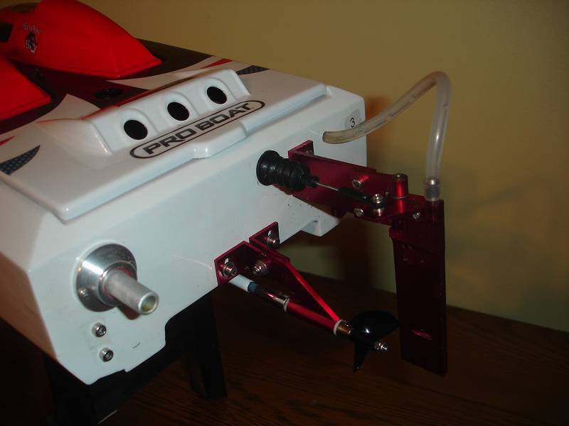

not sure i got a pro boat blackjack 26 ss with the .18 motor and it has metal hardware except for the factory prop

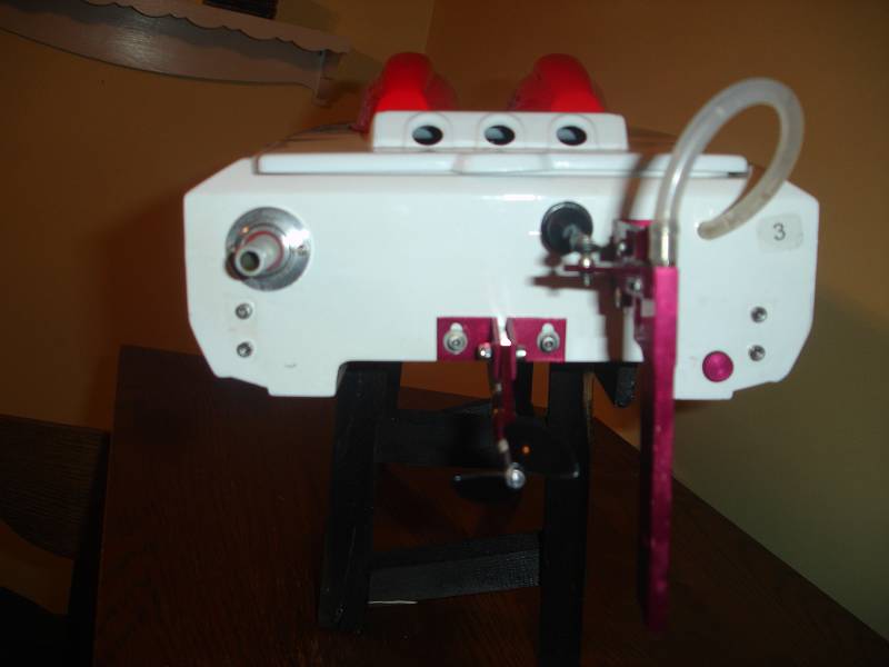

um you will have to give me a day or 2 dont have my camera at the house but the hull is virtually same from what i understand i have not seen the older version in person but it no longer has the .15 engine it is .18 still water cooled of course and is no longer a steerable out drive it has an offset rudder and all annodized alluminum hardware but i will post pics soon just keep checkin!!

blackjack 26 ss pics more to come

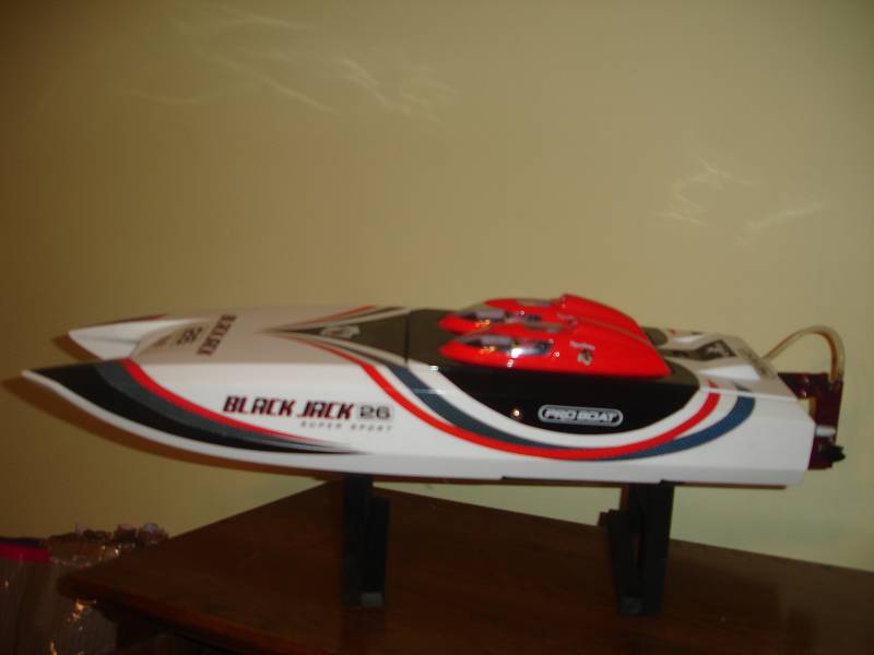

bj26 ss again

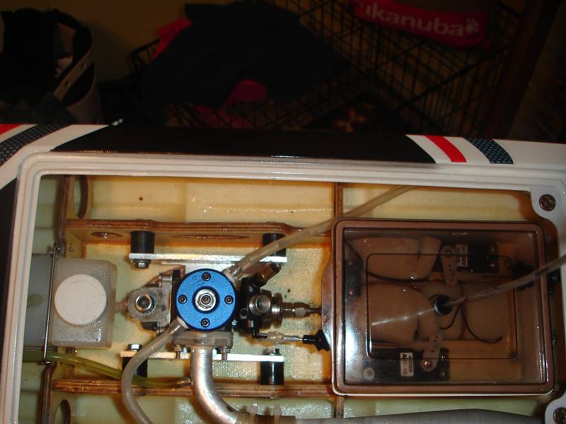

bj26 ss pics

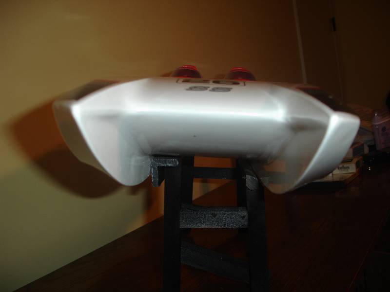

couple more sorry it will only let me do two at a time

anyone have any idea what all the hardware retails for ? would it becheaper to buy an aftermarket drive system for the old bj ?
