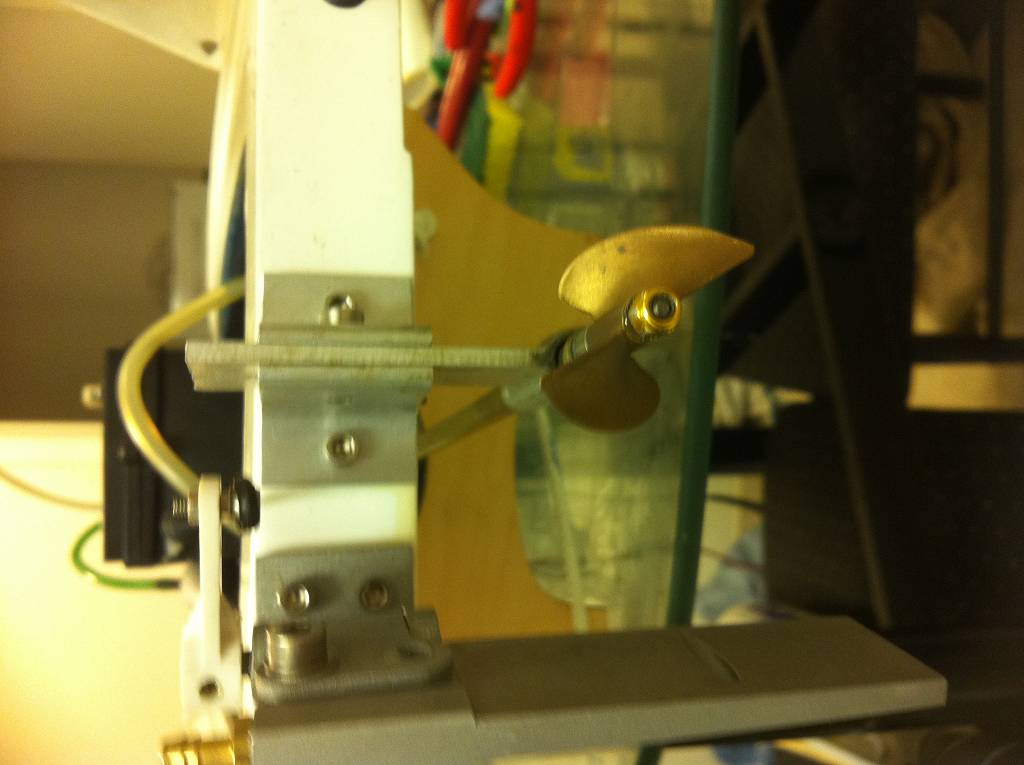

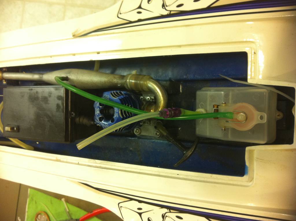

I know there is going to be nonbelievers out there.....but yes it was on GPS TZ .18 Y535 (PROP DEPTH .812) From bottom of hull the center of prop 30% fuel
hit a top speed of 46.7 ran mid 40s all day and witness to ..... have pictures but the server here at rc is having problems...will down load them as soon as possiable

I will be the last one to tell you thats not possible with a .18, I'v done it and then some (but with a bigger prop),, I will say it's a little on the high side for a Y535prop, that TZ had to be SCREAMING with that small a prop.
Where did you have the GPS Mounted???
Wish you were taking Vids and Not Pics of it,,,LOL,, I always love to see a fast .18 Hydro vid[8D].

I've had a lot better results with a X437\3 or a M440 or Zippkits 440. But not with a TZ Personally but know a few that are running the TZ and spining the 437\3 prop.

I had the GPS next to the radio box this TZ runs much differnt then my friends tz,s it has always had much more rpm ...it has 3 to 5 mph more then the others boats...and everything is the same between boats, I have no answers for this

Your not getting an accurate reading on the GPS unless it has a CLEAR View of the sky, especially the LOGO as most GPS manufacturers put the Antenna under the LOGO.
