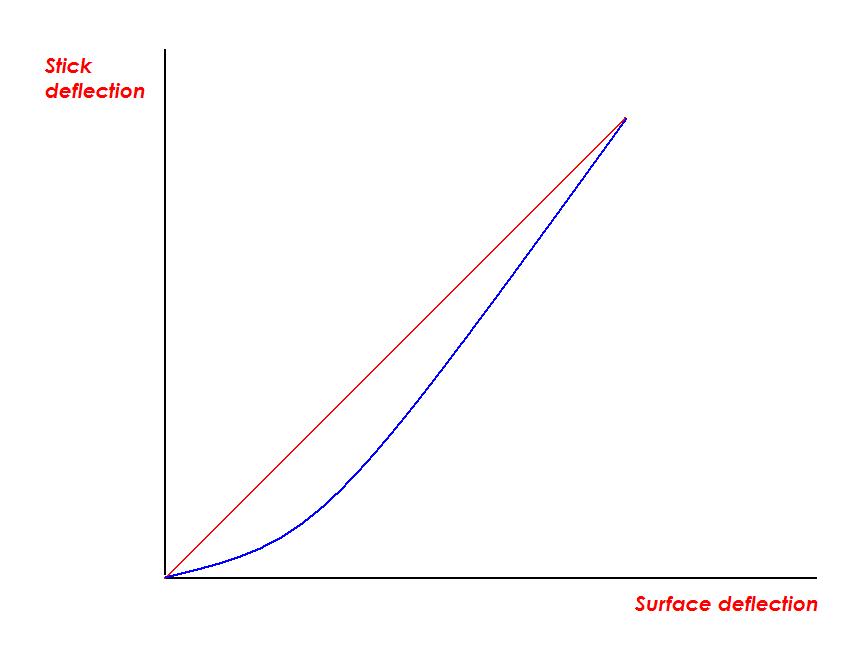

Lnewqban
Lnewqban's Avatar
Join Date: Apr 2007
Location: South Florida
Posts: 4,057
Default RE: Exponential versus Linear controls
I was wondering how could I have missed one of Mike's articles!
Returning on the exponetial........while driving home I was thinking that:
If the expo does not change the start and end points, i.e., the range of the control surface deflection, then, the sensibility that is lost around the central point of the stick, must be amplified for the last portion of the deflection.
For higher percentage, that difference should be more noticeable.
Is that incorrect?
(Sorry thailazer, no thread hijacking intended.)

MinnFlyer
MinnFlyer's Avatar
Join Date: Apr 2002
Location: Willmar, MN
Posts: 28,519
Received 8 Likes on 8 Posts
Yes, the more you add, the "softer" the center becomes.
What's important is that at the ends, you always get 100%
