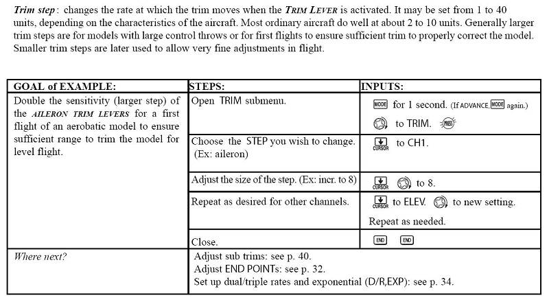

Tuwood, I have the 7c also. How do you adjust the sensitivity of the trim?
Thanks, MikeB
Old 03-29-2006 | 09:44 PM
tuwood's Avatar
Joined: Nov 2005
Posts: 841
From: Omaha, NE
Default RE: Digital Trims?
ORIGINAL: WMB
Thanks, MikeB
rather than me trying to explain it, here's a picture of page 39 of the manual.
The default is 4 units (whatever the heck a unit is)

Tuwood, I found it in my manual. The radio was so easy to setup for everything else, I didn't bother to look at the manual. Good info there.
Thanks! MikeB
