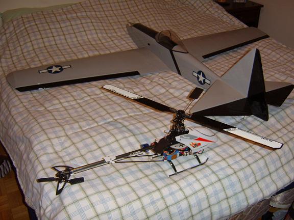

I have recently traded for this plane which I have been told is a Ace Cloud Dancer 60. I am looking to put an engine and electronics in it but I have no idea what to get. This is my first airplane and I could use some advice. Also any hobby shops online that have good prices would be helpful because I dont have access to LHS. Thanks for any help I have included a pic of the plane.

Get a trainer. That Cloud Dancer isn't a good trainer or good first plane.
Go to the Beginners forum and read the sticky on trainers.

the most inexpensive 60 size engine you van find as if this is your first plane and with out help from any one chances are it will not survive long.use a large diameter low pitch prop so as to keep the speed slow and constant to allow more reaction time but the best thing would be to trade it for a trainer even a small one.

You can't afford NOT to start with a trainer. That Cloud Dancer won't last 1 minute if you're a rookie pilot. Why waste the money on it. You'll most likely destroy it.
Set it aside. Save it for the future.
Find a flying club. Get a trainer. Learn to fly with an instructor. Use the Cloud Dancer as your 2nd or 3rd plane.

Yes, if you have flown helis, that is a big difference. The Cloud Dancer is an excellent plane, it's just not designed, structurally to take the sometimes harsh treatment a trainer routinely gets. If you can buddy box with an instructor, you have a good chance for success. If you are truly on your own, the CD may be short lived. Best of luck!

probably could use standard servos that come with a 6 channel radio on that plane. on the landing gear you can probably hunt through tower and see if the original gear are still available. most likely it had wire gear in the wings. ps just looked and tower doesnt have this plane listed or parts for replacement. and you could get a thundertiger 60 that would be cheap and would work in this plane or even a super tiger 61.

Here is the manual for the cloud dancer 60 ARF. you will be able to see what the landing gear looks like.
http://www.modelflight.com.au/manual...uddancer60.pdf
Standard servos will be good, but if the budget allows it a digital sport servo like the Futaba 3152 would be better
