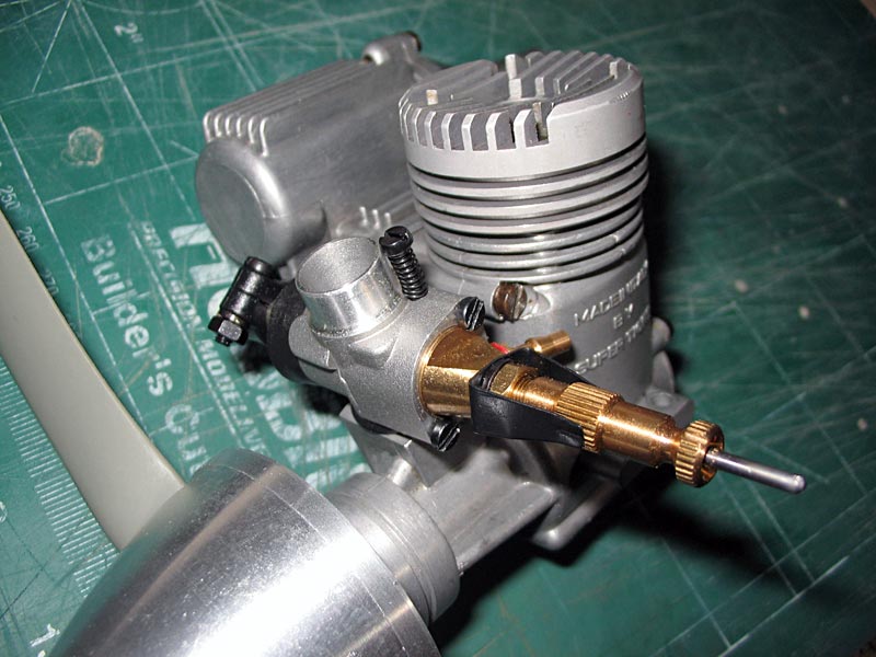

Hi
I have a supertigre x25 from the early 80's and need to replace the needle valve and the spraybar assembly. Can you tell me if i can get these from your company.
Thank You
Michael

The parts you're looking for have not been made in two decades. While a needle is available from a third-party maker, the spraybar assembly is not. You'd have to locate one through an internet 'swap shop', or from a dealer who sells parts to engine collectors. They usually advertise in small ads in the back of model magazines.
A needle can be obtained from Harry Higley and Sons:
HIGG2200 NVL001 LARGE NEEDLE S15 3000 US$4.95
You can order this through any hobby retailer.

I know this is an old thread, but I put a brand new G-34 carb on my X.25 and it fits perfectly and runs great.
David

If the G-34 carb fits, there's no reason not to try it.
