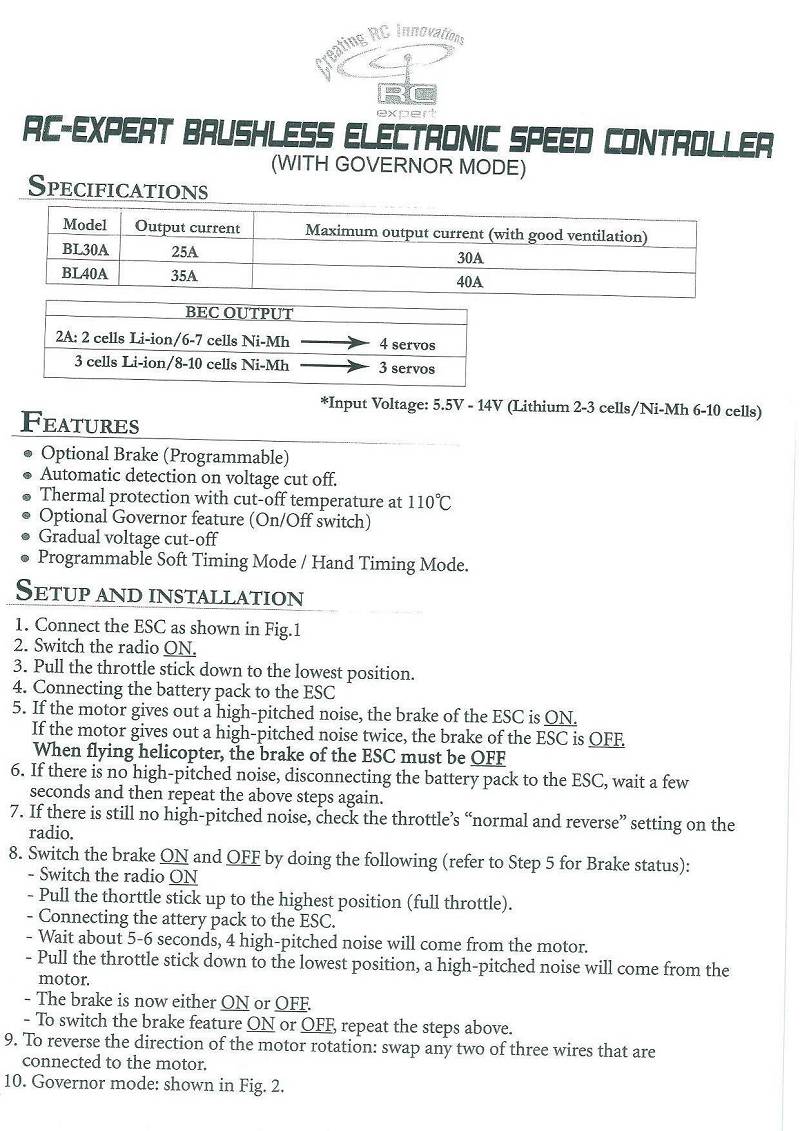

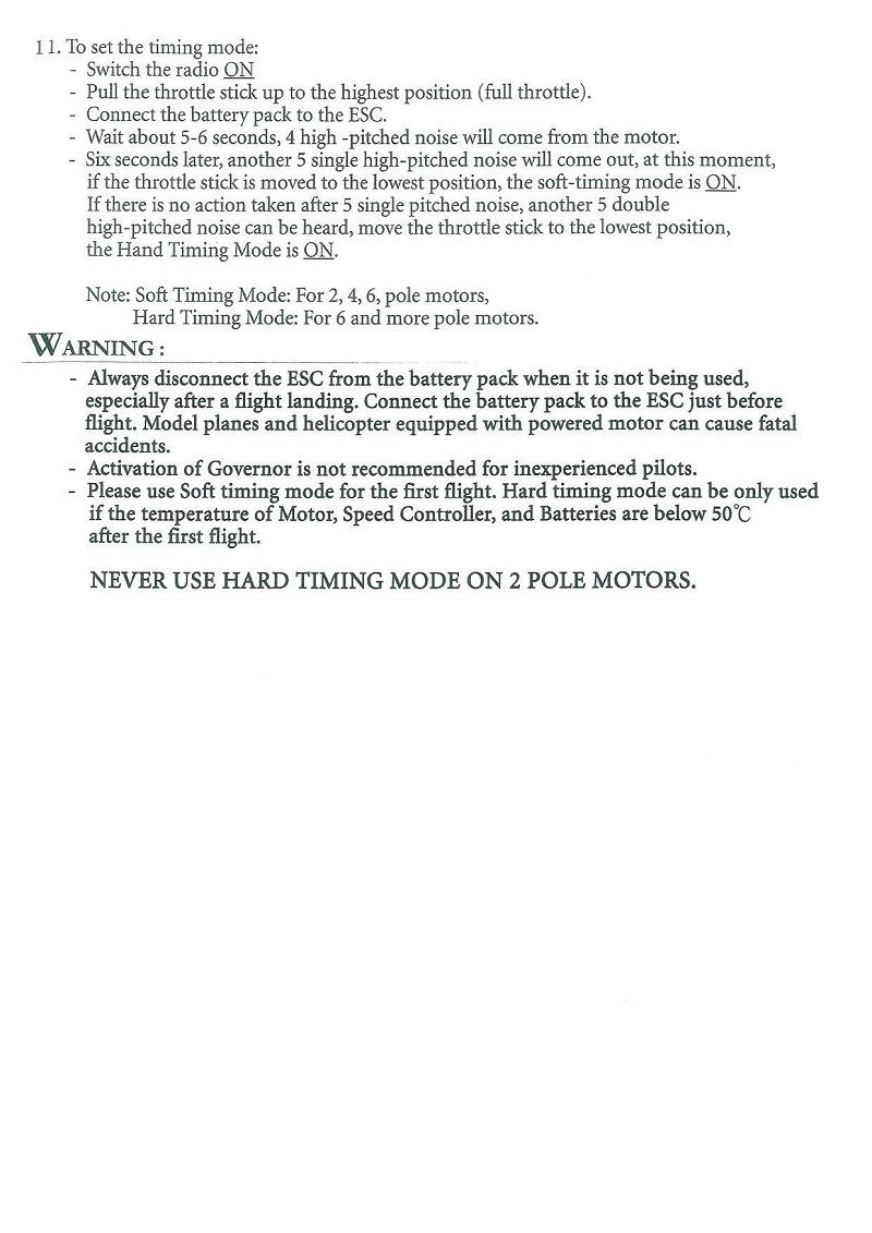

Does anyone know how to set the R/C Expert 40A ESC. I got one with no insstructions.

Default RE: R/C Exper ESC
hope that helps
