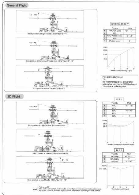

Ive had a T-rex for awhile now. I just bought a blade angle gauge from HobbyTown. Im pretty much a newbie with helis and I think my blade angles are screwed up a bit. Im using the Futaba 9Z with a 13 point curve....
Can someone give a reference or an idea what the blade angles and the throttle curve should look like?

Do you have a Trex manual? Maybe you want to download one. [link]http://www.heliguy.com/i/T-rex%20450%20XL%20manual.pdf[/link]
Here is what you want to know:
Rafael
