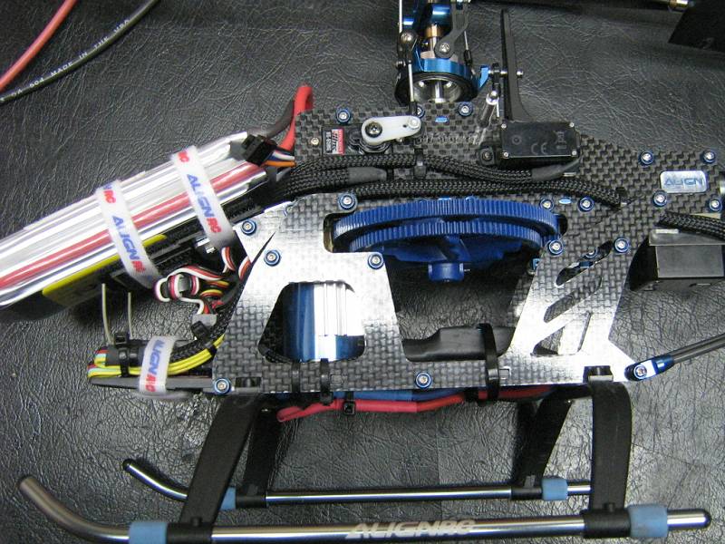

Here is my clean wire setup.
Extra gyro wire in bundle beside receiver.

What I use goes by a few different names but typically it's called braided sleeving or as boystoys listed, expandable nylon sleeving. When you grab the ends and push it expands out so you can worm your cable through, if you get it from a computer store as a kit it typically comes with matching color heat shrink to bind the ends (I find cable ties can be messy but they do work as well).
[link=http://www.newegg.com/Product/Product.aspx?Item=N82E16899998039]braided sleeving[/link]
