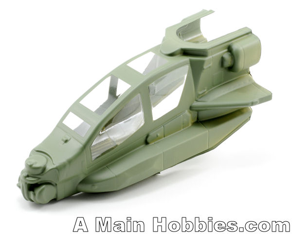

PAYNEZOO HI the trex you got from lhs is the main frames plastic ????
check this body out sweet looks nice anyone have one and how does it fit to trex450??
http://www.amainhobbies.com/product_...ducts_id/32853 <<this is place that
has the shell
