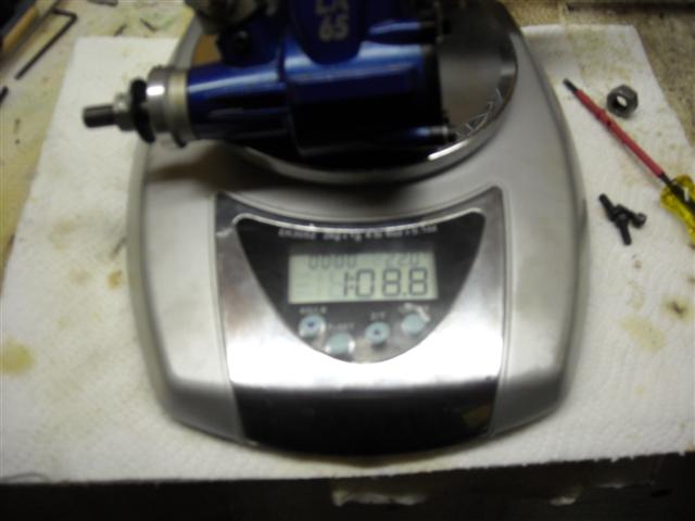

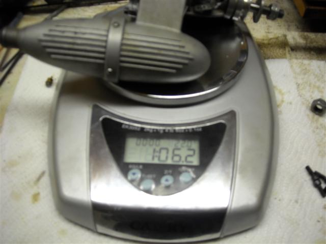

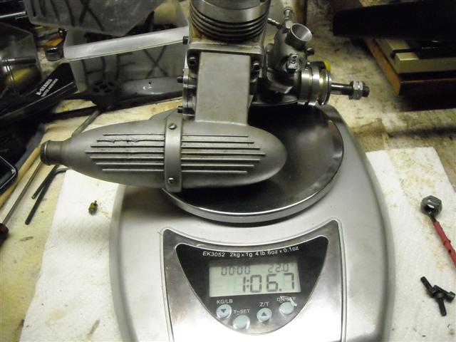

Ernie, here the weights of a Fox Eagle 4 .74, a Fox Eagle 4 .60 and a LA .65, al are wearing their stock mufflers, prop washers and prop nuts. The Fox .74 is the lightest due to its thinner sleeve. I pulled the Davis Diesel heads off of all three and mounted the stock heads to make the weights stock weights.

Hobbsy how does the fox compair to the 65's above rpm numbers?
On your scale what are 1:06.2 stand for? kilograms or what?

The Fox .74 weight is 1 pound 6.2oz, the Fox .74 turns a Graupner 12x8 at 11,200 and the .60 at 11,000 even on 5% nitro with 20% castor lube. As a Diesel conversion the .74 turns a Graupner 12x8 three blade at 9,650. The respective weights in oz would be,
Fox .72===22.2 oz
Fox .60===22.7 os
LA .65====24.8 oz.

That's good homework Hobbsy, thanks. You really went the extra mile and it is interesting. The Fox 74 would be the way to go then, and amazing that it is lighter than the OS 65 which is bushed. Or do the Foxes not have ball bearings?
