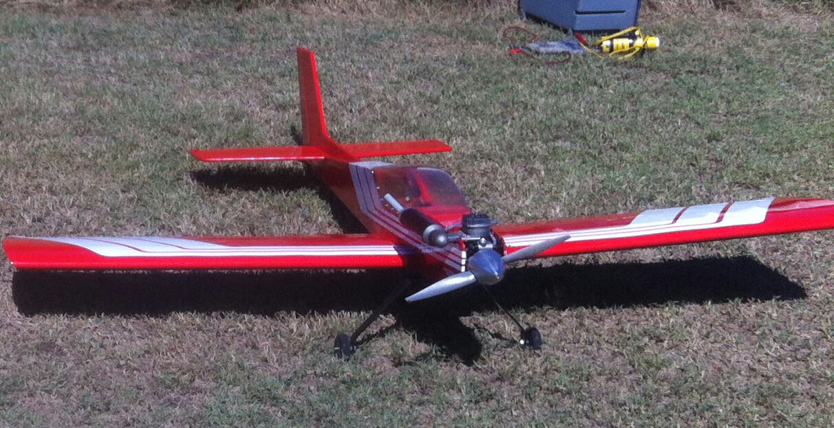

I ended up moving the spray bar down also, but haven't moved it up leaving the mid range a little on the rich side. I drilled my engine mount through added a spacer and bolted without the adapter.

I won't need the spacer myself but I'll be doing the same thing. I just need to get a vice for my drill press before I drill the engine case.
