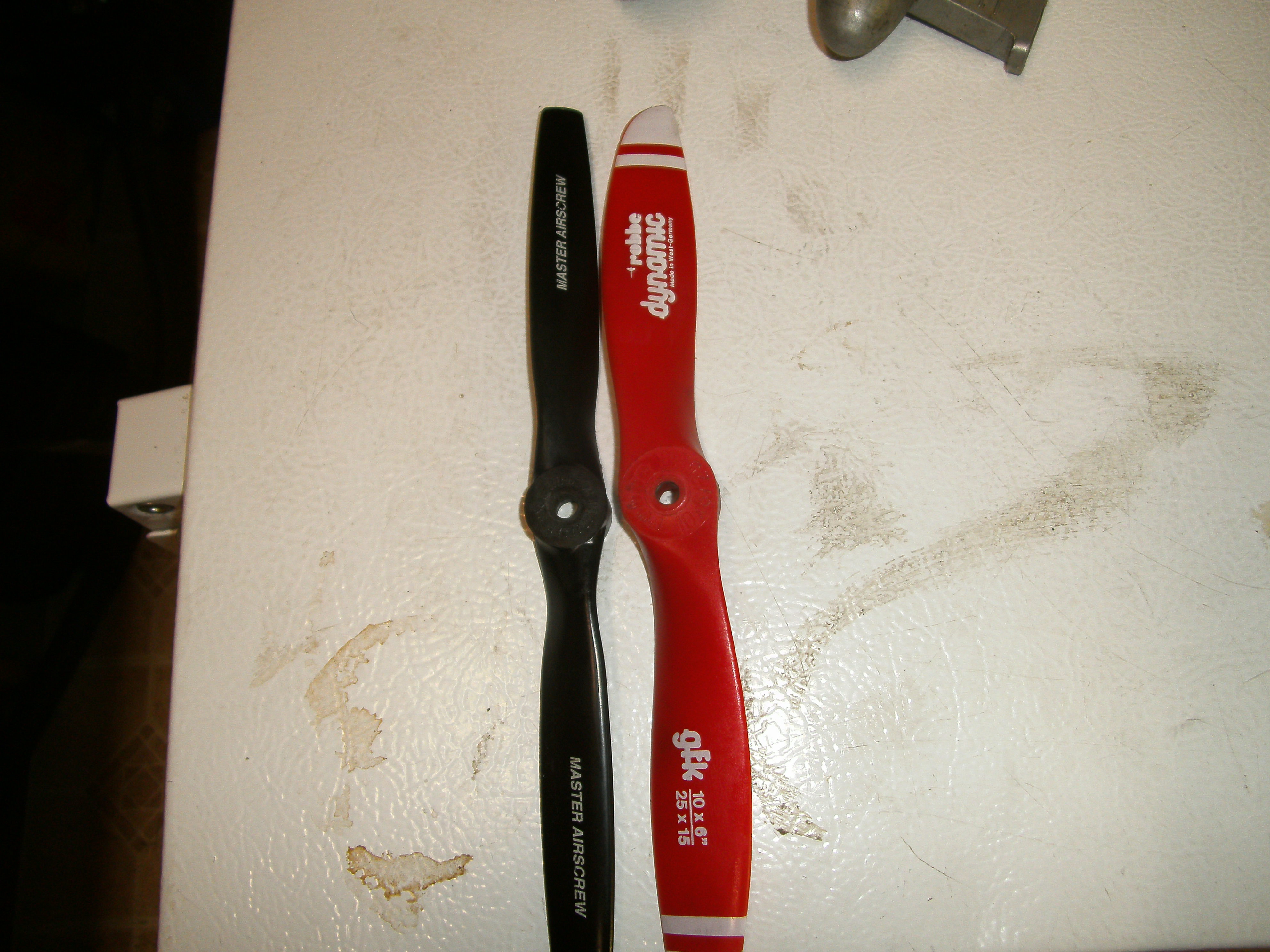

Do you gents mind if I post Fox .46 ABC numbers here. I will use the black prop pictured here, the red one has huge blades but still turned 13,089 on a Fox .50 ringed engine.

The black Master Airscrew if 10-6, it is the same as the prop in my tests, ya, the more the merrier. I would like to know just how much greater the Jett is as well as pretty much everything that size. Especially with no muffler, as the results vary so much. A Jett muffler can make any strong motor even stronger too. Using a pipe is so variable, that the results would not prove much, but a Jett pipe would be good. Wish I had one.

I hope you don't think I'm weird but I never run engines in a configuration that I would not fly them. The difference between the pictured props is way more than I would have thought. I took the ringed piston and sleeve out of a .46 engine that I converted to a .50. I installed a little used .46 ABC sleeve and piston.
Engine===Fox .46 ABC circa 1988/later lower compression head button.
Fuel=====Wildcat 2/4 10% with 18% full synth.
This engine was super rusty when I bought it from a guy out west. It has BOCA Ceramic bearings which are still glass smooth. They have only been run in Diesel conversion mode.
Exhaust==MVVS .49 sized muffler
Plug=====Ancient Fox Idle Bar
Prop=====Robbe 10x6, red in the picture
Prop=====Master Airscrew 10x6 pictured
RPM with Robbe======12,990
RPM with MA=========14,790, astounding to me and a pleasant surprise. When I fly it I will use the Robbe though, it created the most wind and the least noise.
I guess that makes it about 99 rpm less strong than the .50. With the Robbe.

I'm not surprised you saw the differences that you did. The blade profile of the Robbe is wider and probably pitched closer to its advertised pitch much like APC. I've often encountered very different rpm figures when comparing MAS to APC. I will say that MAS props are more durable, but they're known for having more blade flex, make more noise, and the actual pitch being a bit less than advertised. Not nitpicking here, just making observations and repeating what others have said. Nonetheless, the Fox ABC .46 makes respectable power which is good to know since I have a new one sitting in its box in my engine cabinet. It's a shame it didn't have the spinner with it - just the spinner backplate.
