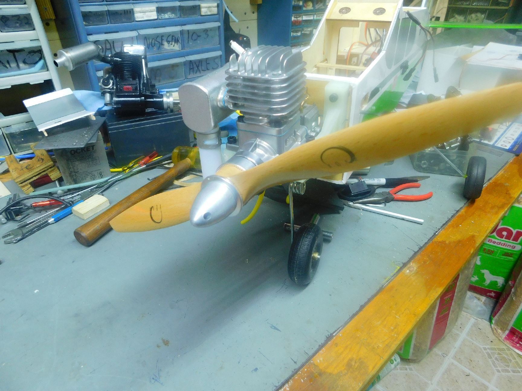

Mine is mounted on a Sig LT 40, the green one. On 93 octane ethanol free it turns a Xoar 13 x 7 at 9,330 rpm. Lube mixed at 40 to 1.

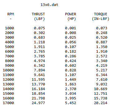

The APC performance chart for the 13x6 prop at 10,000 rpm shows 0.828 hp and 7.9 pounds of thrust... see below:
