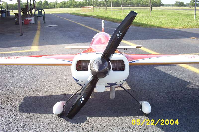

Tried a new prop and like it! Prince P-Tip 27x10, getting 6280, and its a fat prop.
