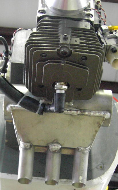

Fairly new Quadra Q100B.
100cc single with only 3 gallons thru it.
I customized the Bisson exhaust with 1" pipes and I run Amsoil series 2000 at 50-1.
TNC tach, 70 deg day.
Surprisingly smooth running single...I also run a ZDZ80 twin.
2 blade
Menz 27x10 6000 rpm
Menz 28x10 5700 rpm
Bambula 26x10 6400 rpm
3 blade carbon fiber
Engle 25x12 6000 rpm
FHM 25x12 5500 rpm
Hope to get more after a few more gallons of gas.
