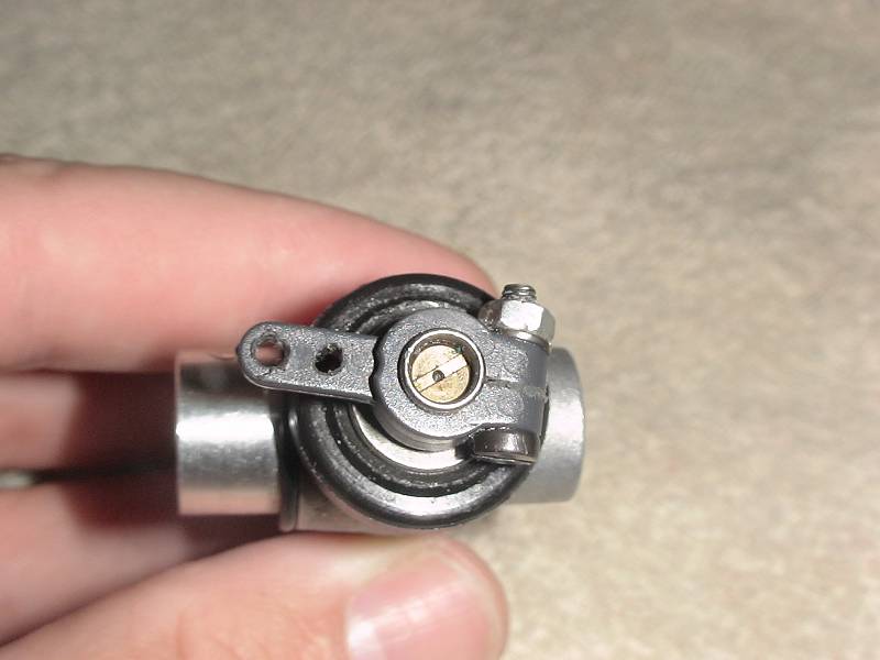

Alright guys, I need some help. A little info on my setup- I purchased the G90 second hand on ebay (perhaps the first mistake, I was waiting on getting the funds for an Evo 1.00 but oh well) so I have no history of the engines use or care of the engine. I am using a new SuperTigre Sport Glow Plug Medium Heat Range from towerhobbies.com. The prop on the engine as seen in the below video is a Master Airscrew 14x8. I have also tried and MAS 13x8 and APC 12x6 and all end in the same result. I think that I am not getting a rich mixture at all and the engine overheats and shuts off when I move past 1/2 throttle. It will idle for 5 to 8 minutes and shut off. I am not sure what I need to do. I am hoping that the video will shed some insight from you experts. Also, I am using Cool Power Max 15% as fuel.

#112
So that I am crystal clear that we are talking about the same thing, you mean the screw located in the center of the carb in this picture:
It seems that it all the way in, so I will turn it out and see.

The low speed needle will affect running at high speed . Mine had to be set 1/3 the way into the cat eye of spray bar and using the pinch method at idle around 2500 to 3000 rpm adjust so there is no rpm increase when pinching and then adjust high speed again and recheck idle. After adding the perry pump all my problems went away. And said, I use no nitro, this engine does not like it. Running a master airscrew 13x6 K series turning 11,900.
#116

Many people have their low speed adjustment that is located in the center of the carb on their ST Engines way too lean, and it will quit fast and furious when advancing the throttle quickly to wide open if it is too lean. Want to burn up an engine fast, just keep running the low speed adjustment too lean. I adjust mine with the engine running and with a steady hand and fingers, and I have all of them intact and uncut, but I can not recommend this to everyone, but it has worked very well in my success of setting the low speed carburator adjustment correctly and my ST Engines advance smoothly even with a quick wide open throttle from idle. Of course you can do it by trial and error and shutting the engine down for a safer method, but it takes longer. Just do not turn the low speed adjustment more than a 1/8 of a turn at a time. My ST Engines do not quit and will idle very reliably and not quit when advancing the throttle either. Remember, small changes in the low speed adjustment goes a long way. More sensitive than the high speed seems to be, I feel. Personally, I think more people should use a Perry Pump that will maintain constant pressure to the carb no matter what attitude your plane is in and it will do this no matter how low or high the tank is in relation to the engine. Not all planes allow for the ideal location of the fuel tank and a Perry Pump is the ideal solution for engines running lean after they burn off some of the fuel in the fuel tank.
