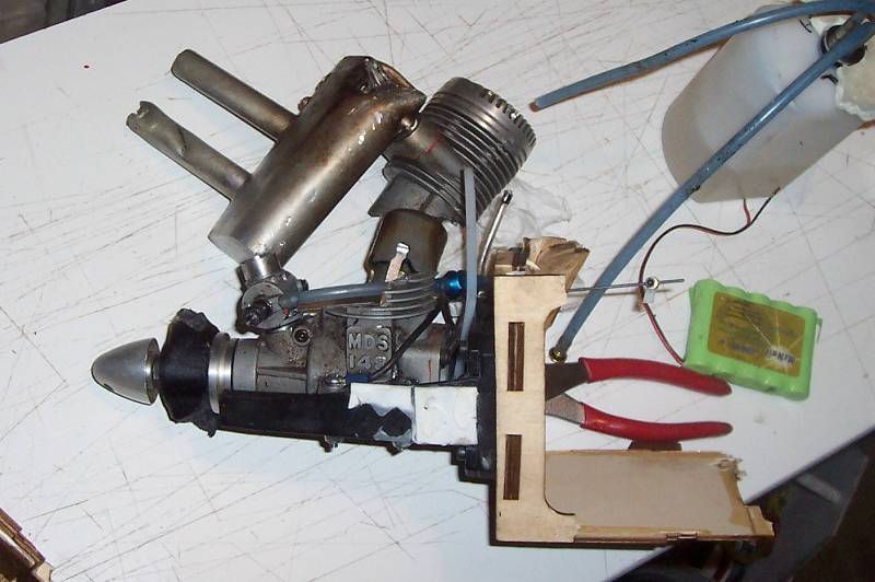

The only time I ever broke an engine into pieces was when the same thing happened. Mine went into a loop at high speed and came down through a big tree. Yours looks worse than mine did. I think I forgot to put the screw in the elevator servo arm. Never did that again!

MDS will not cover that under warranty.
